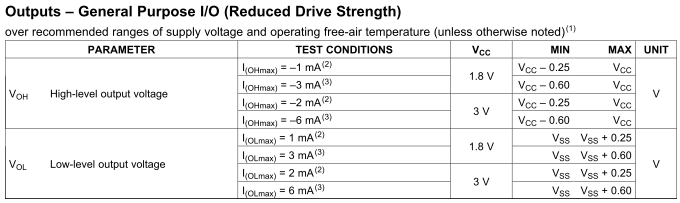

Out customer will use TCA9517 with MSP430F5659 on the B side of the device. MSP430 VOL specification is in the following table.
Would  there be any source current from TCA9517 B side to MSP430 ?
I am asking this question because TCA9517 B side requires VOL < 0.4V for normal operation.
MSP430 would not be able to keep VOL < 0.4, unless its sink current is lower than 2mA.

    The MSP430 has to be able to drive the pull-up resistor low.
    If you know your VCC value, and you know from the MSP430 table above what current (Imax) you do not want to exceed, you can select a pull-up resistor such that VCC/R < Imax. This sets the limit on the strongest pull-up resistor you would want to use.
    Figures 3 and 4 on the MSP430F5659 datasheet (page 58) will give you an even better idea of the EXACT current where VOL=0.4V
    The amount of current that will be coming from the 0.5V offset voltage on the B side of the TCA9517 is negligible compared to the current through the pull-up resistor.

    We will promote these devices together and ask them to use the pull-up resistor to meet 2mA of sink current with margin.
