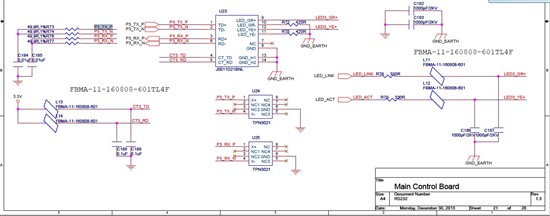

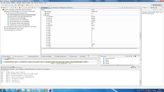

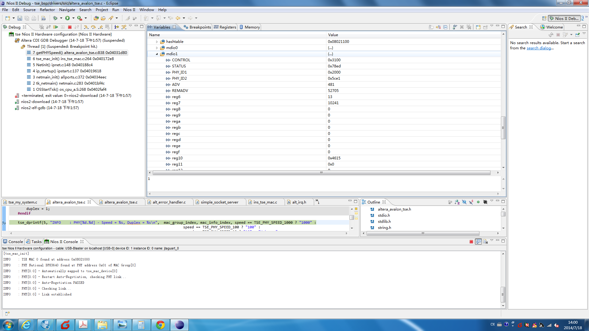

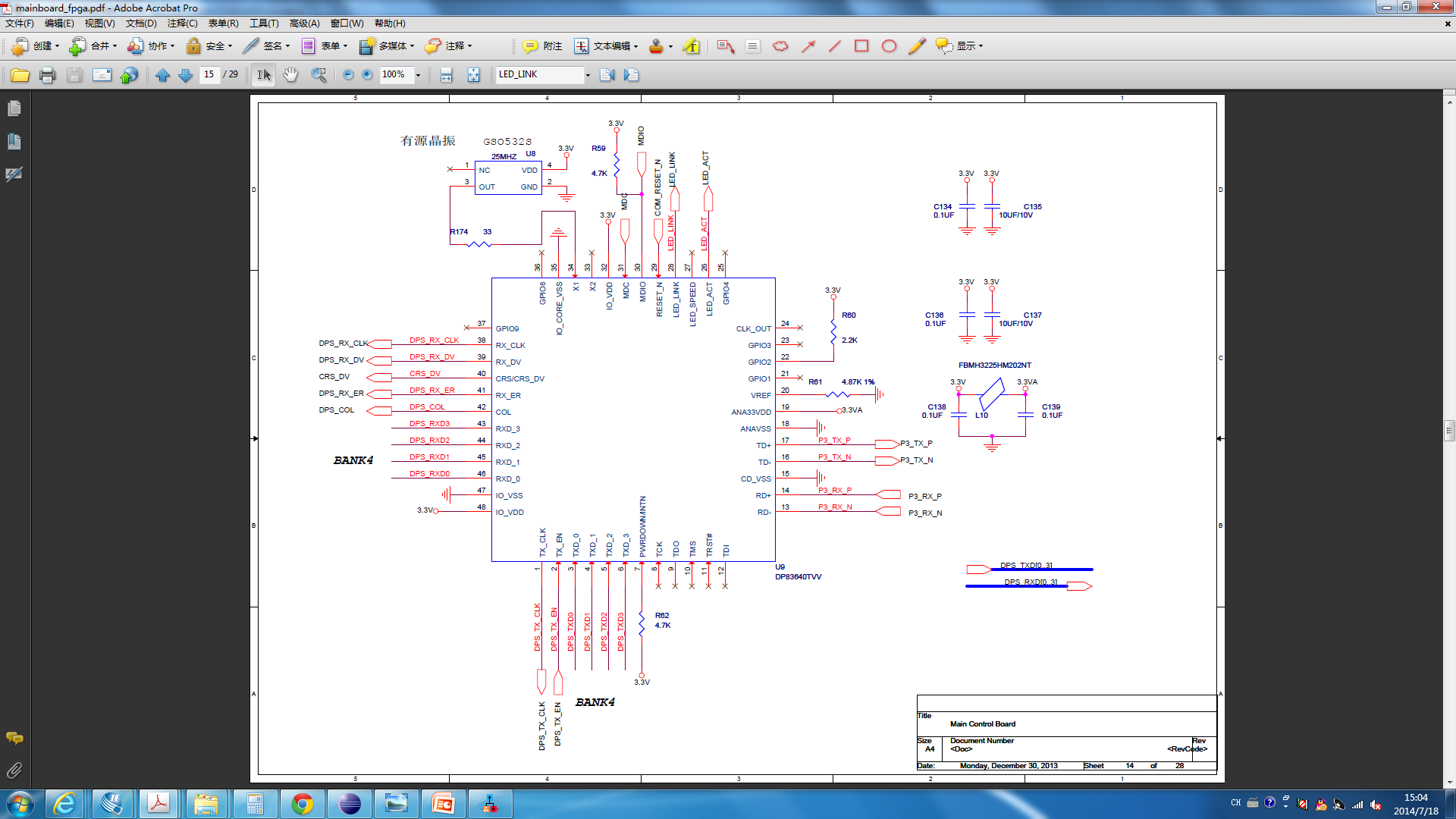

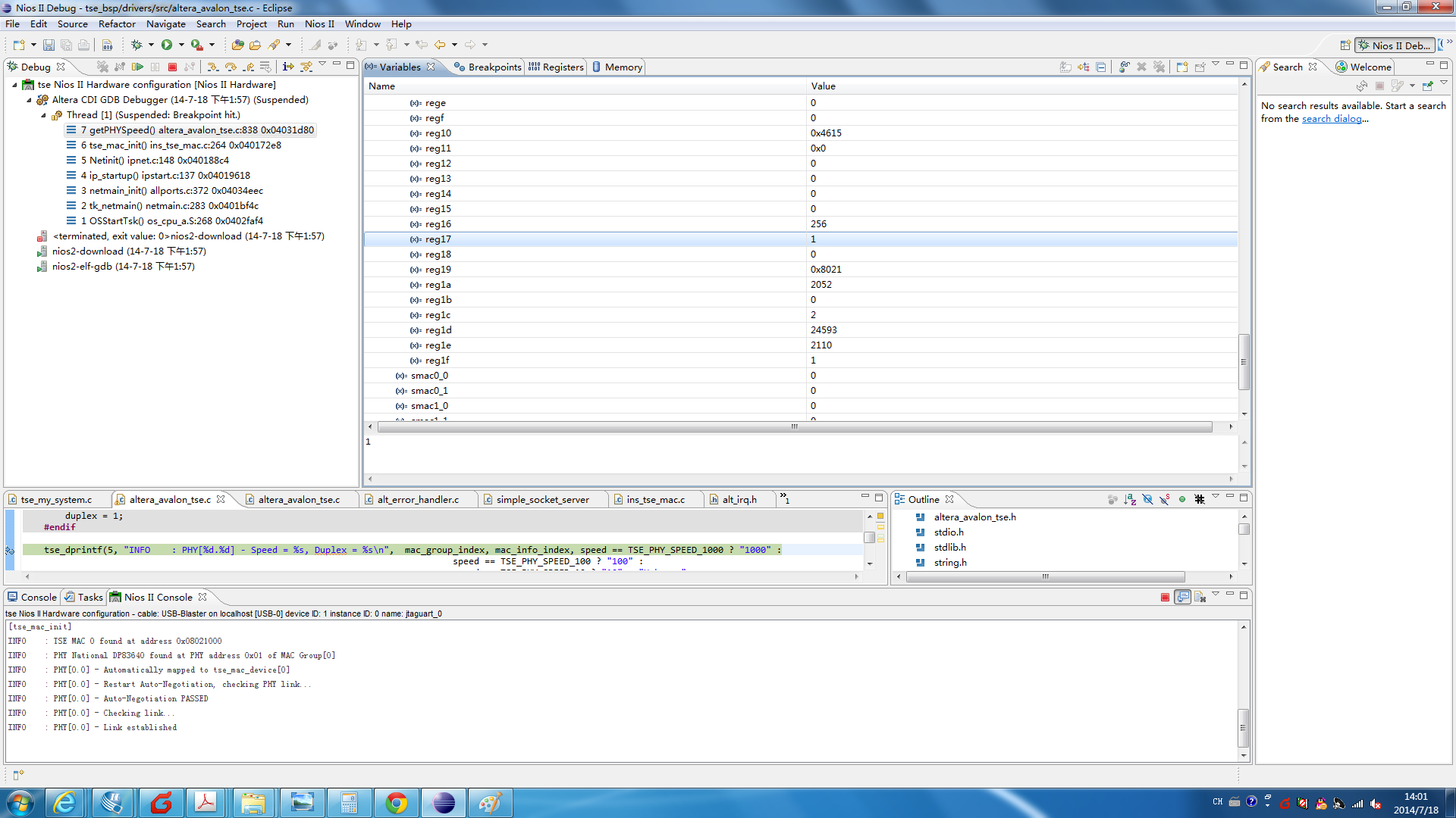

We use the FPGA of the altera ,and use the nios2,use the Triple-SPEED Ethernet IP core as the mac layer.
and we use the DP83640 as the phy. We use the standard MII mode!!!
DP83640 transmitted frame ok,But receive frames with CRC error!!!

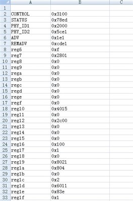

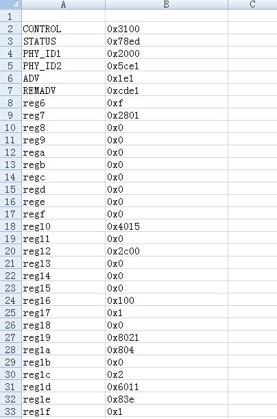

Here the registers value of the DP8360 ,between the 0x00 to 0x1f.Please help us to check it.Tks.
