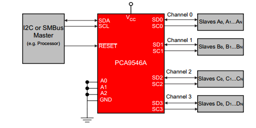

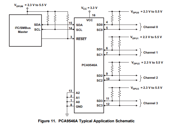

How PCA9546adwr is interfaced with multiple device & any schematic diagram for it..?

Hello Karthik,
The PCA9546A is a I2C switch, meaning it is able to connect multiple channels of I2C together to a main bus. See pictures below of an example
You address the PCA9546A and tell it which channels you would like to have connected to the main bus (SDA/SCL pins). The master may communicate with the slaves on the individual channels.
