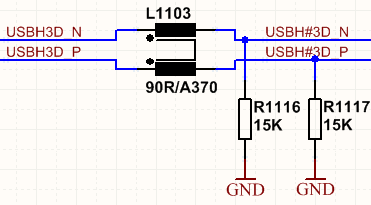

    I have another questions regarding USB outputs of hub TUSB4041I.
    We often see that on the lines D+ and D-, we have pull-down resistors of 15kohms connected to GND. Are these resistors necessary on these lines ?
    Moreover, we often use common mode shock; are these components used everytime on these lines ? Or just when the signals go out from the board ?
    Thanks a lot for your help.
    The 15K pull downs are internal to the hub, the chokes are needed only if you are going to put an external USB connector.
    Thank you for your answer.
    I have designed like below, with an output of TUSB4041I on left side and external USB connector on right side
    It is working like this; you said these 2 resistors are not needed ?
    Thanks for your confirmation.
  • Correct, you don't need those 15K resistors, they are already internal in the hub.
    Thank you very much for your fast answer.
    I don't see any data in the datasheet about these internal pull-down resistors. However, I see in the schematics of the evaluation module that they are not implemented.
    Regarding USB Host upstream, do you know if these resistors are needed ?
    Thank you for your support.
    The TUSB4041 does not implement these PD on the upstream port, if your USB Host does not have those internal then you will require to populate them (many hosts already have them internal, please double check)
