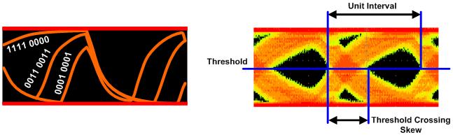

    What causes Jitter?
    Signal jitter is primarily due to inter-symbol interference (ISI), which in turn is the net effect of several causes of signal degradation. One cause is the attenuation and the dispersal of frequency components that result from signal propagation. Another cause is "pattern-dependent skew", which is the variation of rise and fall times that follow the varying sequences of ones and zeros of pseudo-randomly generated binary patterns (PRBS). A data pulse responds to these effects with a loss of amplitude, displacement in time, rounded edges, and a "smearing" of the pulse into adjacent unit intervals.
    Figure 1a shows the ISI, or pattern-dependent time skew for three different bit patterns. Here a series of ones followed by a zero charges the cable capacitance to the highest line voltage possible. This combination of bits will therefore produce the longest fall time to reach the zero crossing point. In contrast to that, for a string of zeros followed by a one and then a zero, the one-to-zero transition starts falling from a voltage much closer to the zero crossing, thus taking less time to reach the zero crossing.
    Figure 1. a) Pattern-dependent skew and b) eye-pattern diagram
    Measuring the signal transitions over a wide range of PRBS data yields an eye-pattern such as the one in Figure 1b. An eye-pattern allows a visual assessment of the quality of a transmission link. The less ISI the smaller the jitter, or eye-closure, and the wider the eye opening. Eye-closure or jitter is expressed in percent and is defined by the ratio of the threshold crossing skew to the unit interval:   Jitter (%) = threshold crossing skew / unit interval.
