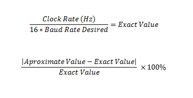

When referring page 26 to 28 (Figure 8 to 11), we could found baud rates related tables.
On each tables, PERCENT ERROR DIFFERENCE BETWEEN DESIRED AND ACTUAL is described individually.
Please let us clarify how each percent error difference could be calculated.
