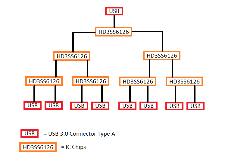

Hye....
Hereby I had posted a block diagram for developing USB 3.0 Multiplexer 8:1. Is this method possible ?
Will it have any transmission delay or signal integrity problem ?
Hope you guys can help me out...Thanks

using the above topology you will have only one USB device working at a time and every time you switch to another USB device it will have to be re-enumerated.
You will also need to be able to identify which of the 8 USB connectors is the one connected to the Host.
Your topology seems more like a Hub-based topology.
Can you elaborate more on your implementation?
