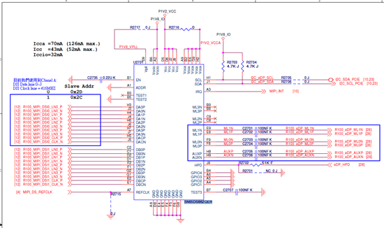

Dear Team:

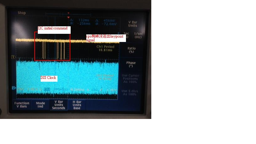

Our customer used SN65DSI86 in their panel, but some panels are work, the others are failed that panel are all black screen. The work panel which we measured I2C and DSI clk gotten key point siganl is as below,after loaded initial command file. The fail panelscould not get key point signalas same rpocedureand down DSI86 register got CHA_SOT_SYNC_ERR.
Do you have any idea about this?
The circuit and register setting are as below.
