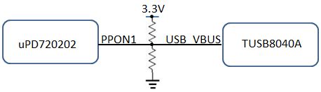

In our customer's application, VBUS is not directly applied to the TUSB8040A. If they are using a 3.3V signal, what should be the resistance value instead of 90.9k||10k ?

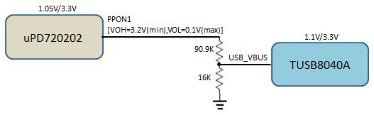

Hello Kato,
You can use something like 90.9K/16K if the VBUS input is 3.3V. Please note that tying VBUS permanently high may lead to interoperability issues. The USB specification requires that VBUS go low when the upstream port is disconnected. For example, if VBUS remains high and the host is removed during a low power state, the TUSB8040A may not realize the host is removed and when it is re-attached will expect to see resume instead of new enumeration.

Hi Kato-san,
Yes, that solution would work. The resistor values would need to be modified if the VBUS input is changed from 5.0V to 3.3V. For 5.0V we use 90.9K and 10K, for 3.3V you could use 90.9K and 16K (or similar).
