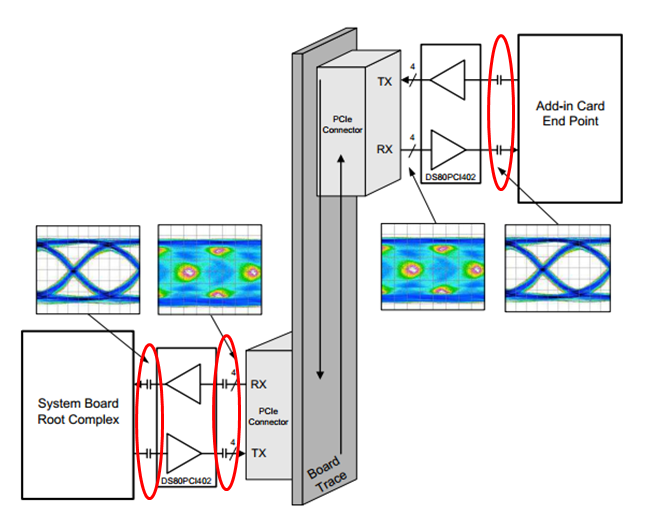

    Are you using AC coupling caps before and after the DS80PCI402? It is very important that the CML inputs and outputs are AC coupled. Standard PCIe specification for AC coupling cap is a cap ranging from 75 to 265 nF for PCIe Gen 1/2 and 176 to 265 nF for PCIe Gen 3. On our Evaluation Modules, we typically choose 0.22uF.

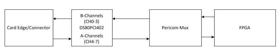

  • Hi Michael,
    Attached is the block diagram.
    We have 100nF caps near all TX pins (at FPGA and re-driver). so this shouldn't be a problem.

  • Hi Kevin,
    Thank you for the block diagram. I am presuming from your setup that the repeater is oriented in a manner like the following below, where B-channels receive from the FPGA, and A-channels transmit to FPGA. Is this correct?
    If you use loopback mode, you will only receive the data that is observed by the B-channel. The EQ and DEM signal conditioning settings applied should not have any effect, since you are directly sending back B-channel input to the A-channel output without going through the Rx and Tx internal stages of the repeater.

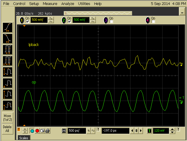

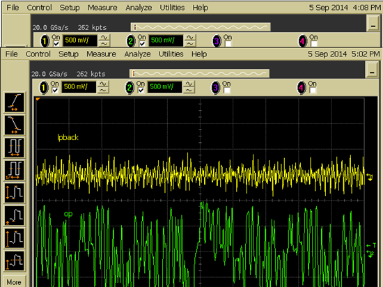

  • Hello Michael,
    I have some scope shots of a 2Gbps sine wave going into the redriver and nothing coming back out while the device is in loopback mode. Also, I have a shot showing a 4Gbps PRBS datastream entering the re-driver and very reduced amplitude PRBS stream returning. Why doesn't the re-driver pass these signals as full amplitude? I have the re-driver settings set very low so there should be almost no signal distortion.
  • Hi Kevin,
    It does not appear that the input signal to the B-channels and the LPBK output of the A-channels correlate. As a sanity check, can you verify that you have tied a 1kOhm to VDD on the LPBK pin (pin 23) so that INB_n loops back to OUTA_n? If not, you can override the LPBK pin voltage in SMBus mode by writing Reg 0x02[0] = 1 (Override LPBK) and Reg 0x02[5:4] = 10'b (INB_n to OUTA_n).

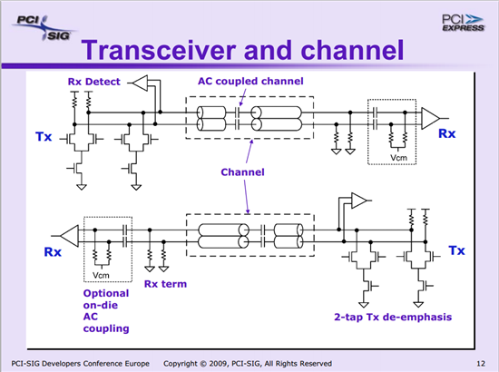

    Thank you for confirming the DC bias voltage for the device. After some further investigation this is certainly the cause of our issue. It appears that your re-driver is not compliant with the PCI SIG definitions for Gen1 and Gen2 DC bias implementations. The receiver should be terminated to GND rather than VCC as you have it. See section 4.3.5.5 of the PCIe Base specifications Rev3.0:
    "The Receiver DC common mode voltage is nominally 0 V when operating at 2.5 GT/s or 5.0 GT/s"
    There is also a nice diagram from some slides by PCI SIG, note the ground termination before some optional vbias termination on the die for the receivers:
    The hardware we build is unusable due to the bias voltage, and we are looking into methods of salvaging the design, but there is a chance for a total loss. You should certainly make this nonconformity VERY clear in the datasheet to prevent future incompatibility with other hardware manufacturers.
  • Hi Kevin,
    Thanks for your thoughts. I went back through the PCIe base specification and referenced the section you referred to. Though the description says that the Receiver DC common mode voltage is nominally 0 V for 2.5 GT/s or 5.0 GT/s, there is no indication in the specification about the allowed Receiver DC common mode voltage range like there is for the Transmitter DC common mode voltage (0 to 3.6 V). This implies that there is a nominal 0 V DC common mode voltage, but not a fixed hard requirement on the exact amount of DC common mode voltage at the receiver.
    From the perspective of the system root complex or add-in card, there is no difference between our repeater having a termination to GND or VDD at the repeater input, because regardless of whether there is 0 V or 2.5 V bias on the input of the repeater, they are both AC GND to the other side of the AC coupling caps. The DS80PCI402 is only intended to be used with AC coupling caps on either side for this reason, because the system root complex of add-in card may be using a completely different DC common mode voltage altogether. Because of the danger in DC coupling, we clearly state that the CML input pins are to be AC coupled, and the AC coupling caps are used on either side of the DS80PCI402 repeater in the application block diagram:
    From the diagram you showed in your last post, there are Rx terminations to GND, followed by an AC coupling cap, then the Rx. If the Rx termination was not to GND, it would still appear as GND from the perspective of the other side of the AC coupling cap. Applying DC bias voltage for the DS80PCI402 Rx should not affect any of the bias voltage preceding those AC coupling caps and any bias voltage provided after the Tx coupling caps following the DS80PCI402.
    For these reasons, I do not believe we are explicitly violating PCIe Gen-1 and Gen-2 requirements. We have had a number of customers use our PCIe repeaters successfully for PCIe Gen 1 and 2 applications over the past 5-6 years without having issues with DC common mode bias voltage at the Rx.
