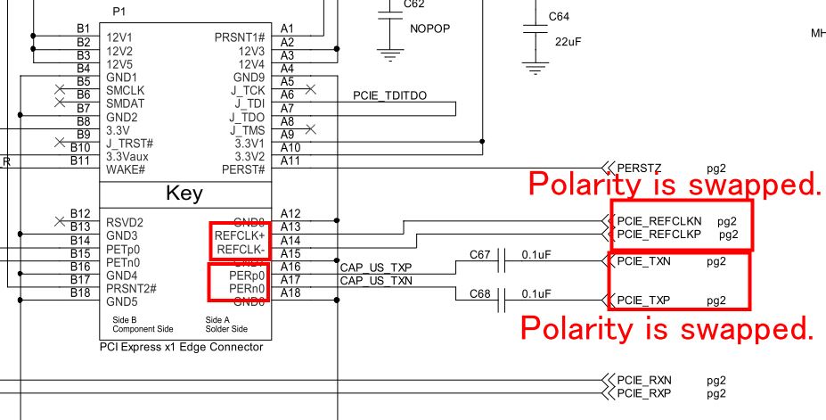

Hi Team,
Please let me ask you about the TUSB7320EVB schematic.
I am looking at the User's Guide : TUSB73x0 Board Design and Layout Guidelines.
In the schematic of this document in page 38, I see some signal connection which polarity are swapped. Please see the below for the swapped signals.
[Q1]
Is this the correct connection for this device ? why are they swapped ?
[Q2]
Our customer had designed their board without swapping the signals. I believe non-swapping connection would be the correct way for the connection but if the user did not swap the polarity would there be any problem ?
