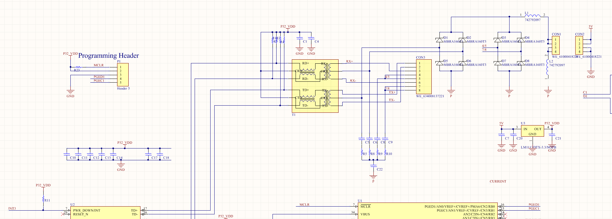

I'm working on a new product concept, and I've got a DP83838 in RMII mode attached to a Microchip PIC32.. I've had hit and miss results and some units have worked fine, and others don't.   When i scope them out,  I find the TX_CLK pin is always dead as well.. I good ones the TX_CLK pin is active..
Replacing the DP83838 has cured it, and then later on its died again.
Is it possible that my choice of Ethernet Transformer is a problem?  I'm using a Wurth 749012011 .
I've just run up 2 more prototype boards, it is a possibility i had something faulty..
Any clues?

  • Ok got a "controlled" Failure, and i'm now sure that the problem only occurs on turn on or plug in.. I think this is due to Transienets that are sneaking across my Transformer  ( Its a POE circuit  )..
    After failure, the PHY draws a lot of current.
    Can you suggest any way of protecting against the transients?

    What PoE type of alternative are you using (is it A)? For the PHY that fails, is it on the PD or PSE side? Are you using a transformer that is PoE compatible?
    Ross
  • See the schematic of the POE Setup..     The transformer is defiantly POE compatible.     The Phy that is dying is the PD side.        DC from the Cable is pushed to a separate DC/DC module via the headers that are on the right hand side.
    Fault only occurs on plug in/unplug.   I'm trying to capture it on the scope but its not that easy!
  • Thank you for the clarification. What chip set is the PD controller? Do you have any ESD termination paths on the PD side? From the schematic all I see is a Bob Smith termination and a diode bridge.
    Ross
  • The PD controller is a NP1093.    (http://www.onsemi.com/pub_link/Collateral/NCP1093-D.PDF)    This is on a separate board, which also contains the DC/DC converter.   ( LM5116 converting the  Poe DC to 5V  ).
    There is D2 across the input power supply, on the second board..  ITs a 1SAM58AT3G, and its there for ESD protection.. I'm not seeing any ESD issues on this side of the transformer.
    I'm sure the issue is on the PHY side of the transformer.

  • Thank you for the schematic and IC used. I will look over the datasheet get back to you. I will check with my coworkers about extra ESD protection. You do have a long path before ESD can be terminated (diode bridge, inductor and headers to another board).
    Ross
  • Hi Andrew,
    It seems like this is a PoE issue like you stated earlier. There are a lot of application notes on proper methods for implementing PoE devices to protect PHYs and other components. For instance, here is a link to an app note on ESD for PoE. (http://www.ti.com/lit/an/slva233a/slva233a.pdf)
    This might help you narrow down the source of the issue and also give you ideas to mitigate the transients.
    TI does offer a large portfolio of PoE devices and reference designs that might aid you as well.
    http://www.ti.com/lsds/ti/power-management/power-over-ethernet-products.page
    Ross
  • I think the issue is'tn ESD, but What is happening at plug in/out.. I'm going to stick a semtech Rclamp0524S in front of the transformer..
