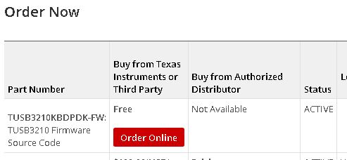

Hi Team,
I could not find the page where you could download the firmware source code for TUSB3210KBDPDK from the below order online button. It says, "File not found & you will be redirected to the homepage in xx seconds."
Has the download URL changed ?
Please also tell me if you would need to customize the firmware or not. Can you just use this source code without changing any program ?

  • Hello All,
    I am also looking for the eval kit source code and ran into the same problem as the original poster. This thread is tagged as answered when in fact it is not. Can someone please help with the source code (TUSB3210KBDPDK-FW) for the eval kit TUSB3210KBDPDK? I would prefer to have a starting example for my keyboard scan application!
