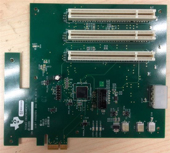

When USE XP OS or In the DOS
It can Find XIO2001 device and show it
but Can't Find the Card on XIO2001 Demo board
in OS CAN load Driver success and show PCI TO PCI Bridge
Bud still Can't find Card on XIO2001 Demo board
Is any other PCI card working behind the XIO2001 EVM?
Does this Intel card works in other system?
Regards.
no
Yes
Can you ship your EVM to us so we can debug it?
Have you tried different OS?
Are the Fuses OK?
