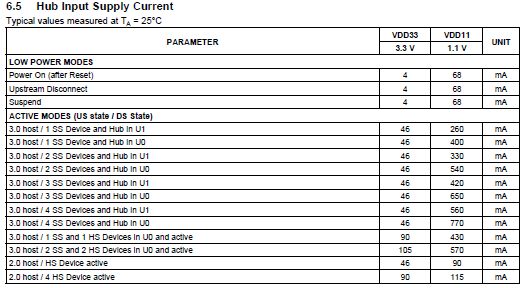

Our customer would like to consider supply current, and the data sheet for supply current says only typ value.
Could you give us the max value information as a reference ?

We do not provide MAX numbers for the reasons Elias stated, but the typical numbers in the datasheet reflect the highest power consumption seen under the stated setup conditions with the power supplies at nominal and room temperature at nominal.
