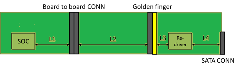

We met the issue when customer used SN75LVCP601 on SATA gen2 and gen3 testing
First Customer used DE=0 dB(VOD=550 mV) and EQ=0 dB(SATA gen2 fail, SATA gen3 pass).
We tried to change the EQ setting to 7 and 14 dB, but the eye diagram looks like the same.
The VOD isn't enough, so we change the DE setting to -2 (VOD=830 mV) and -4 dB (VOD=630 mV)
Then gen2 pass but gen3 fail.
Below scope captures are gen2 and gen3 (DE=-2dB, EQ=14dB)
We also changed the EQ=0 and 7 dB, got the same results (gen2 pass, gen3 fail).
So we used the DE setting to -4dB(VOD=630 mV) to get smaller VOD.
But gen2 pass, gen3 fail.
So is there any possible to change the DE and VOD function separately?
