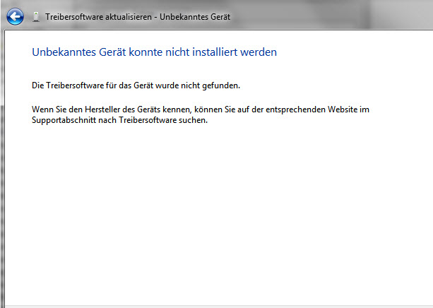

I search a Driver for the USB-Controller TUSB4310. If I connect the Device first time to my PC a Message appears no Driver were found.
If I search for a Driver at Ti.Com I can't find anyone Driver. Please help me to find the correct driver for the TUSB4310 Device. My PC system is windows 7 32Bit

    I guess you meant to say TUSB3410, the driver is on www.ti.com at the "software" tab.
    http://www.ti.com/product/TUSB3410/toolssoftware

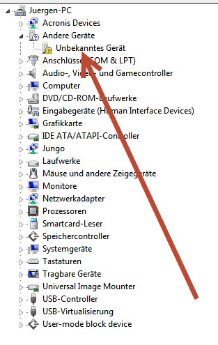

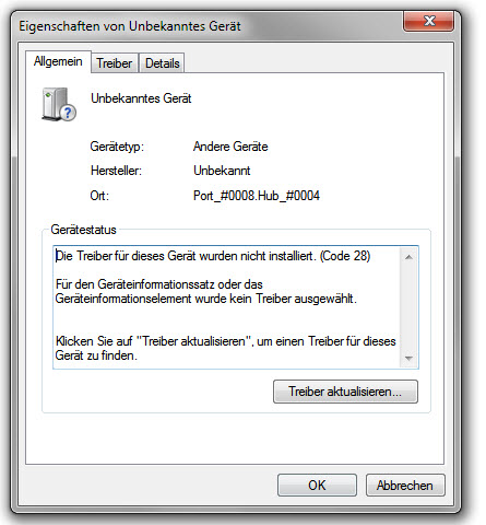

    thank you very much for your answer. I have found the Driver and I have installed the Software. But I have a further problem. If I connect the TUSB3410 via USB at my PC a Message appears,
    The drivers for this device are not installed. (Code 28)
    For the device information set or the device information element no driver is selected.
    If I install the Driver at an other PC, I can connect the TUSB3410 without problems.
    Is there a collision with an other Device?
    How can I solve the collision?
    Regards Jürgen
    the .exe you downloaded from ti.com is just a wrapper, then you have to run the driver installer, did you do that?
    Regards.
  • Hello Elias,
    yes I have unpacked the driver and started the install utiltiy.
    At my PC I have also installed a MSP-FET430UIF with a TUSB3410.
    It may be that there are problems with it?
    Regards Jürgen
  • Hello Jurgen,
    If the MSP-FET430UIF with a TUSB3410 installs their own driver and separately you install the driver that you get from TI.com it can cause some conflicts since you are installing two drivers for the same device, I recommend you to remove any driver previously installed if you want to use the USBUART single driver.
    Roberto

  • Hello Jurge,
    Could you please send me what are you getting on your Device manager? As well the hardware info of the device that is not working (VID/PID, etc)?
    If you only connects the device that is not working in a different system?  The driver install correctly?
    This behavior is only present on your system or you can reproduce It in a different system?
    Roberto.

  • Hello Klaus,
    I have also received your message.
    I think your problem is not your cable. I have also many problems with the USB-Interface TUSB3410. I think you have a driver problem. I have had problems with the installation of the driver. The first installation of the driver did not work. I then looked everywhere for the cause why the USB port is not working. After a long time I have uninstalled the driver again and removed all entries in the registry. Then I reinstalled the driver. The interface is then working properly.
    regards Jürgen
