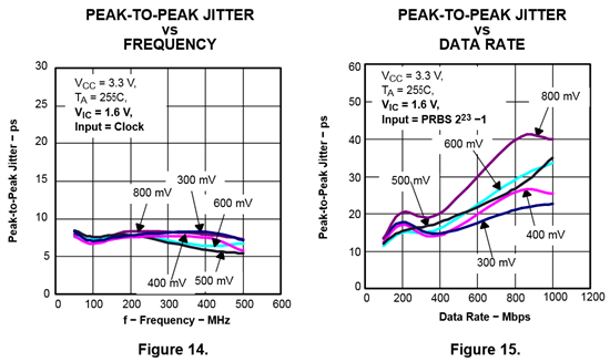

1. Clarification on the differences between bit rate and frequency
I have seen in the datasheet several charts that depict both the peak-to-peak jitter evolution in function of the frequency and the peak-to-peak jitter evolution depending on the bit rate. Having read those charts I do not understand why the peak-to-peak jitter value given a frequency is different from the peak-to-peak jitter value read for the equivalent bit rate at equal conditions.
What I mean by "equivalent bit rate" is for example a signal at a bitrate of 1000Mbps has its fundamental frequency at 500MHz (is it correct?). Then, continuing with both 500MHz and 1000Mbps values, and reading the peak-to-peak jitter values on the two charts below (referenced as Figures 14 and 15 in the datasheet), for 800mV curb the peak-to-peak jitter is 7ps@500MHz on the Figure 14 and 40ps@1000Mbps on the Figure 15.
Thus my question is: why are the two values different each other while I thought they would be equal?
Did I miss something and what?
The question is applicable to both the charts and the table extracted from the SN65LVCP22 datasheet shown below.

    1. You are correct in assuming that figures 14 and 15 share the same fundamental frequency but if you notice in figures 14 and 15 the input to the device is different. Figure 14 shows the the additive jitter from a clock pattern while figure 15 shows the additive jitter from a PRBS23 data pattern. There will be little to no jitter present on the clock pattern (mostly Duty Cycle Distortion - DCD) while the PRBS23 data pattern will contain data dependent jitter (DDJ) and other ISI effects. Clock patterns are typically used when measuring RMS jitter since there is little to no DJ (ISI) present on a clock. The jitter numbers in Figure 15 would change with the type of data pattern that was used. For example if PRBS31 was used for the test I would expect that the number would rise and if PRBS7 was used I would expect that number to fall. To answer you second question from one I would take the number that best represent your application. If you are using the MUX to distribute a clock then figure 14 is relevant but if you are distributing data than figure 15 would be more accurate although the number would most likely change depending on the run length of your data.

    1. Fully understood, it is crystal clear now.
