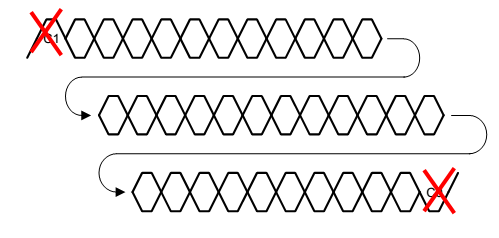

During debugging my customer set which use DS90UH925 and DS90UH926, we have seen short out of lock condition few times. The duration is around 150uS,
(LOCK pin is asserted and deasserted after 150uS.)
This causes the I2C communication failure and are now trying to identify what's going on when this happen.
Have you seen this before? It's appreciated, if you can comment on this.
Ken

  • Hi Jason,
    Here is little more information from customer.
    PCLK: 37MHz (or 75MHz)
    Cable Length: 1m to 2m
    With regards to short unlock status, we have been discussing a possibility than, due to some reasons, deserializer might miss clock information (either C0 or C1, or both) of some 35bit data packets. When following valid data frames supplied to deserializer, deserializer can achieve lock condition again.
    Do you this this is the possible case?
    Ken
