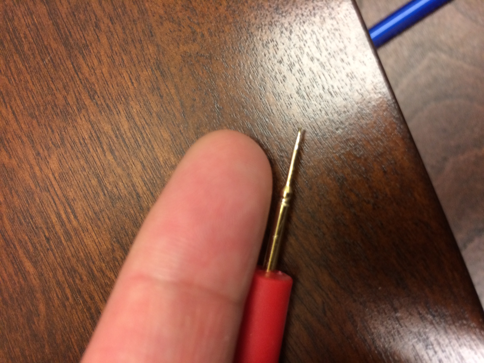

  • Hi Ross,
    Thanks for you reply.
    No, I did not touch the crystal. Nor did I apply much pressure to the caps, simple using the tip of a probe (shown in Fig.1) to get a contact with the caps. Only one touch is needed for reviving the crystal and PHY, that is the SPEED LED is on after one touch. However, another operation, which may not even directly talk with PHY, (e.g, MDI read, PHY reset, or just downloading code into spartan 6 microprocessor) will turn the LED off, which indicating that PHY is not generating RX_CLK or TX_CLK. To complete the loopback test driven by spartan 6, I need to continues touch the caps during the test, with either a finger or a tip of probe.
    Fig 1
    I will check the connection of the crystal. But I doubt it is the cause of the  problem since I did not touch it whether the loopback test was successful or not. Fig 2 is the photo of the board. There is a mess around C78 and C79 since I did soldering a multiple times there. But each time, I did check the connection of the soldering with multimeter.
    Fig 2
    Hope this helps you to understand this problem better.
