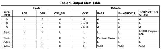

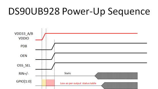

Can you please let me know the status of GPIO[1:0] under following conditions?
1: During VDD ramp up
2: After VDD reaching to range, before PDB, OEN and OSS_SEL are ramped up.
These GPIO ports are connected to other devices, it’s preferred to keep low during transitions above.
Thanks for your support in advance.
