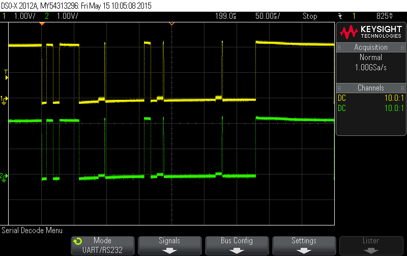

HI,
I used this IC to convert from 3.3V rail to 1.8V rail and vice versa. And I used 1.5k resistor as pullups on the both sides. On the SCL and SCL lines at the 1.8V side, Iam getting 2.3V. this voltage persists even after the pullups are removed. Also I confirmed that the destination side is not at all loading. The voltage is actually PCA9306 is sending out even the pass transistors are in off state.
Kindly can someone help me with the appropriate solution.
