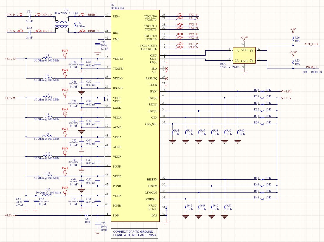

I am using FDP link and the parts used are DS99R124 and DS99R421 FPD. Attached are the schematics for the tx and rx. There is a flicker at the receiver end. Not sure what I am doing wrong. Any help appreciated.

Madhu,
Can you also send the layout? Most likely it’s something in the layout. Taking a quick glance at the schematic I noticed that you are using ESD protection with 3-5pF, I would recommend protection with a maximum capacitance of 1.5pF. I would try depopulating this socket and seeing if the problem is resolved. If so I can recommend a replacement.
Mike
