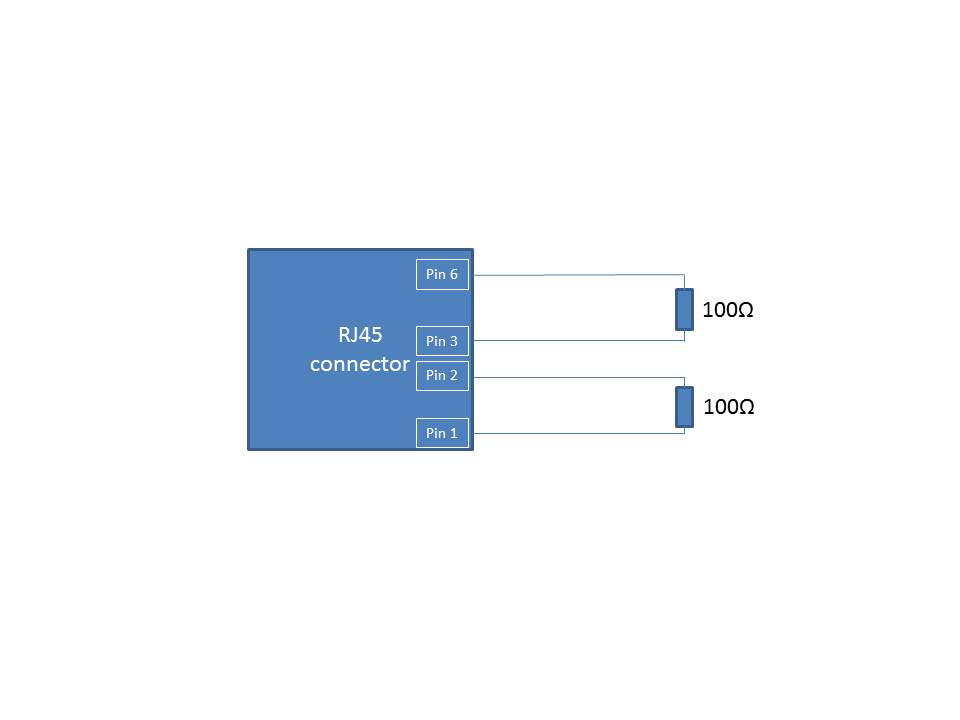

  • Hi Hubert,
    Here is a simple diagram to help you visualize the connections you need to make. You should add 100ohm termination between pins 1&2 and also between pins 3&6.
    Ross

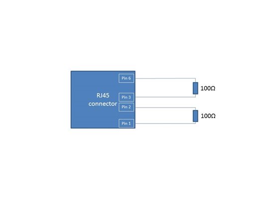

  • Hi Hubert,
    For analog loopback:
    You want to place one 100Ohm resistor between TX+ and TX-.
    You want to place one 100Ohm resistor between RX+ and RX-.

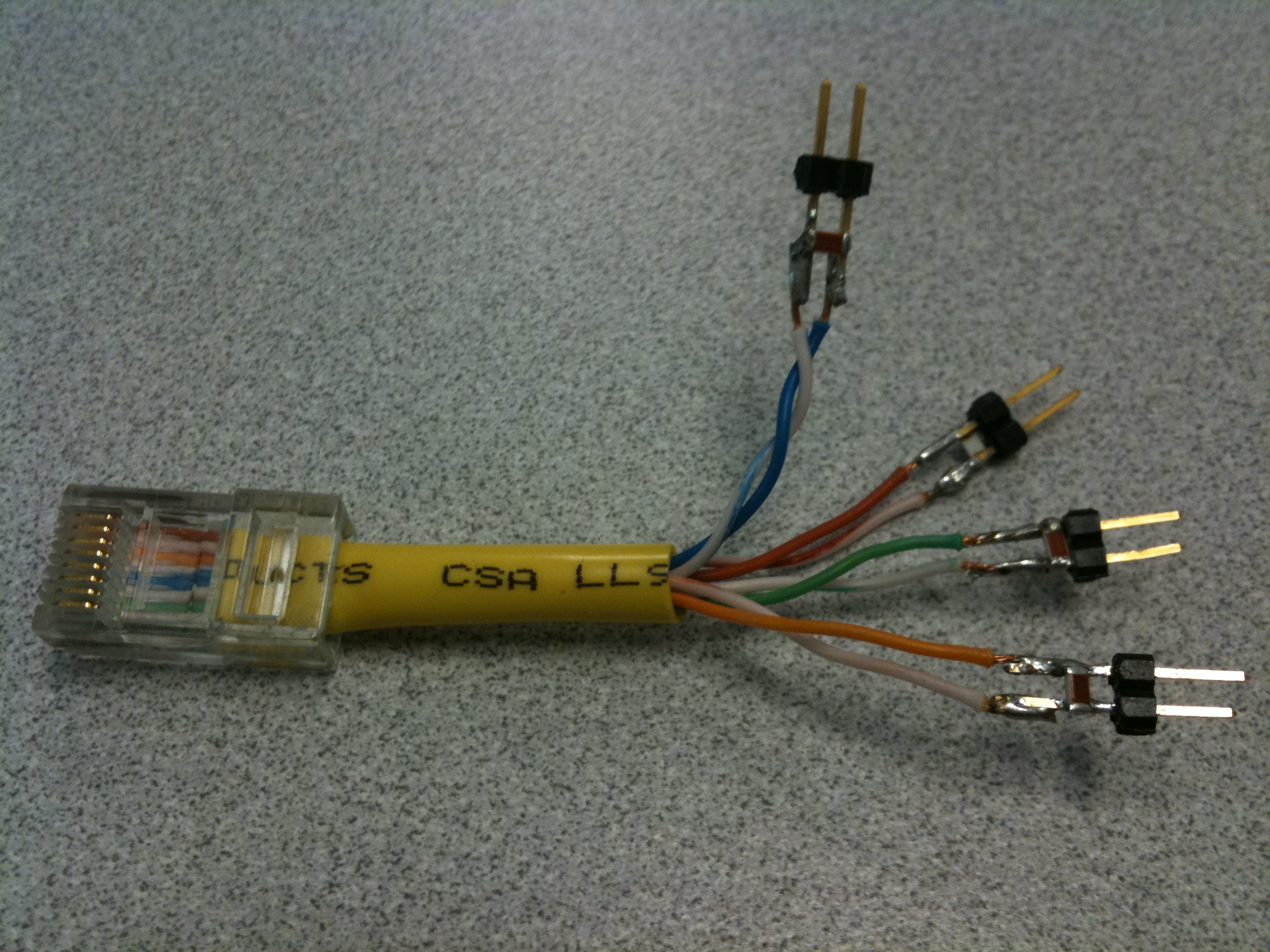

    Here is an image of the cable you should make for analog loopback.
    As you can see....a 100Ohm resistor is connected between pin 1 and pin 2 and another 100Ohm resistor is connected between pin 3 and pin 6.
    Ross

  • Hi Hubert,
    No worries at all. Answers to your questions:
    No, the pictures above represents the cable that is recommended for proper operation with analog loopback I can see why with is confusing since there are two loopbacks that require different cables.
    1. Analog loopback needs a termination cable seen above for proper operation.
    2. External loopback needs a loopback cable pictured in Figure 3-5 of the datasheet.
    The two cables are completely different. Analog loopback has 100 Ohm terminations at the end and connects as pictured above. External loopback is a direct connection from pin #1 to pin #3 and from pin #2 to pin #6.
