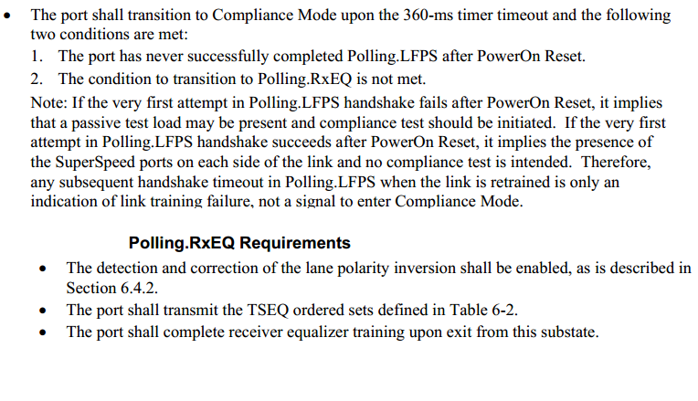

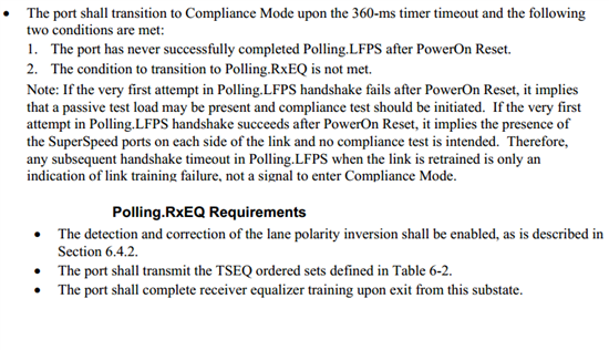

  1. When will TUSB7320 turn on its downstream USB termination, right after power up? And under what condition termination will be turned off?
  2. After detecting far end termination, for how long will TUSB7320 enter compliance mode?
We have a platform that TUSB7320 will sometimes enter compliance mode when resuming from S3 and may need this information to further check it
