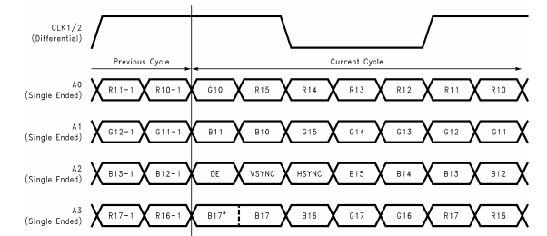

My client have a question about DS90C387 data mapping. They use 24 bit panel. In the datasheet data mapping as below picture.
But in the application note AN1162, data mapping as below picture.
DS90C387 data mapping sequence are different in two documents. My customer want to know which one is correct. They are very confused right now.
