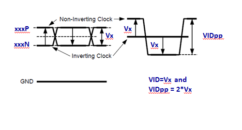

Q2. Please let me confirm if the definition, of VID and VIDpp in Section 9.4 and 9.6
of the datasheet, is as bellow?
    As illustrated in the attached file, assuming that positive and negative of the
differential input (xxxP and xxxN) toggle with an amplitude of Vx, (measured
in single ended way), VDI is equal to Vx and VIDpp is equal to 2 times of Vx.
