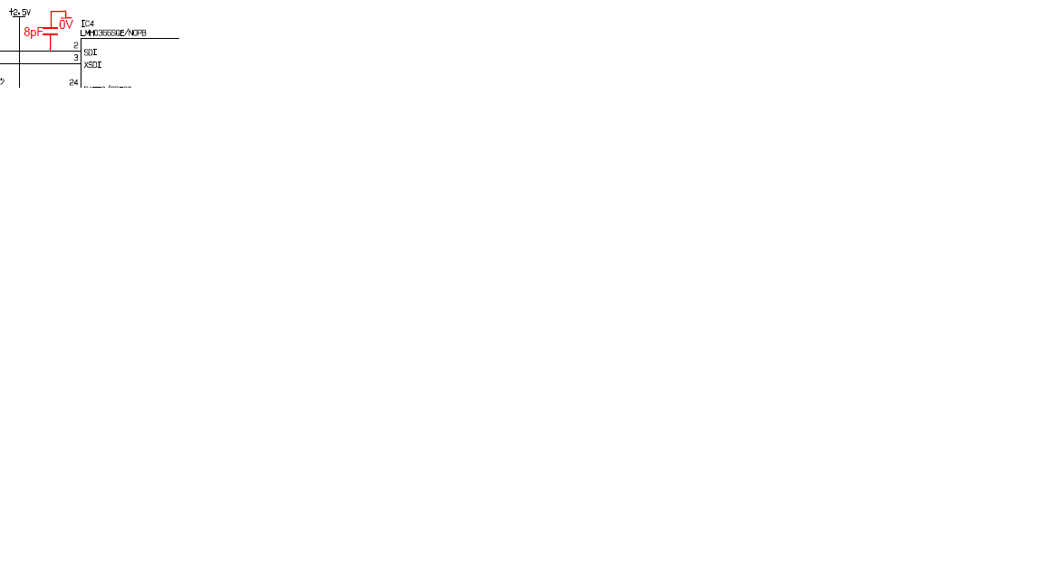

Our customer designed 80ch splitter but 5ch of them is not good jitter characteristic.
130ns required standards , but about 170ns was measured.
Jitter is getting better if input cable is reconnected after disconnected but there is case it is not rarely getting better.
In that case,if power is restart,jitter is getting better.
Although our customer assume related reclocker,could you provide any support?

    In addtional information , they confirm when capacitor is placed between SDO of equalizer and SDI of reclocker(LMH0366),jitter is getting better.

  • Hi Nasser
    Customer does not do AC couple but they placed capacitor like below.

  • Hi
    Our customer confirmed that jitter is reduced when external crystal is removed.

  • We got update from our customer.
    I would like to correct their phenomenon.
    They have confirmed that signal is stable if external CLK was 27MHz + 80kHz and in the referenceless mode,signal is not stable.
    They are considering using 27MHz + 80kHz.
    Are there any concern ?
    Please support about the above.
    Best regards.
  • Hi Alpha,
    There is not any concern. The external crystal is used to start up the PLL and once the device is locked it is not used any more. Here is my email address so you can send me their latest schematic for review: nasser.mohammadi@ti.com
