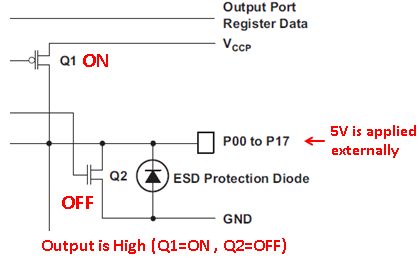

    I understood it in the following way.
    So, could you please let me know the behavior of TCA6416A at this case2?
    [Case1]
    P-port is configured as an output Low (Configuration Registers=”0” , Output Port Registers=”0”)
    <your comment>
    If a P-port is configured as an output LOW and 5V is applied externally, this will cause a short to ground.
    [Case2]
    P-port is configured as an output High (Configuration Registers=”0” , Output Port Registers=”1”)
    <My comment>
    Could you please let me know the behavior of TCA6416A?
    My customer worries that this device is broken in this case.
    Kanemaru

  • Kanemaru-san,
    In Case 2 there will not be damage to the device, but why would you apply 5V externally when a P-port is configured as an Output?

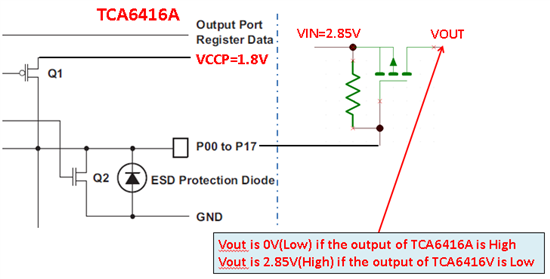

  • Hi Brian-san,
    Thank you for your support!
    Our customer is studying the following circuit.
    So, they would like to use the output like the low active.
    Could you please let me ask the following question?
    [Q1]
    I understood that the voltage of the P-port pin is High(1.8V) when a P-port is configured as an output High(1.8V) and 2.8V is applied externally.
    Is my understanding correct?
    [Q2]
    This device has the 5V tolerant I/O ports.
    Therefore,  I understood that the current from VIN can't flow to VCCP.
    And, could you please let me know if you have any advice?
    Kanemaru
