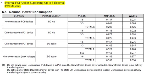

Dear Sir
If downstream insert six PCI device ,How about the max power consumption of XIO2001 ,Thanks
