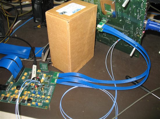

I'm using the DS80PCI800 as a midbus PCIe probe. It is okay in pin mode, but as soon as I switch ENSMB HI, the outputs are muted. Do you have a required sequence of commands to switch over to SMBus control? I have tried a lot of different commands including disabling the CRC and different RXDET settings. I am seeing the ACK go LO at the expected times when I write to the various registers. It mutes as soon as I raise ENSMB and put LOs on AD3-AD0.

  • Hi Austin,
    Once ENSMB is pulled high with a 1kOhm resistor to VIH (3.3V if VDD_SEL = GND and 2.5V if VDD_SEL = Float), the device should immediately revert to SMBus Slave Mode control. The outputs should not be muted by default coming out of the DS80PCI800. However, it is likely that there is a large amount of over-EQ when the device is in SMBus Slave Mode, the EQ defaults to 0x2F (~24 dB), DEM defaults to 010'b (-3.5 dB), and VOD = 101'b (1.2Vpp).
    I have a few questions so I can get a better understanding of how to debug:
    1. Can you provide a schematic of the connections to/from the DS80PCI800 on your board?
    2. What were the pin mode settings that worked for you before switching over to Slave Mode?
    3. Are you able to read back register values from the DS80PCI800 in Slave Mode? If so, can you please provide a register dump from the DS80PCI800 so we can see what the DS80PCI800 is doing?
    Michael
  • Hi Michael,
    Thank you for your reply! My pullups are tied to 2.5V and VDD_SEL is tied to GND so I have that wrong. The only pullup I have is the 1K on the DEMA0/SDA signal. Will that really make a difference? I'll try moving it to 3.3V. All of the others are not loaded. I enclosed a pdf schematic with the picture. The Serdes inputs have a 50 ohm series isolation resistor to minimize loading on the midbus connection. All of the SMB signals are coming from a Stratix IV Altera FPGA using LVCMOS 2.5V levels. I'll have to check if those outputs can tolerate 3.3V. As I said, the part is ACKing the address and data bits, although I have seen it ACK at the wrong time, suggesting that I'm not getting my ST and SP signals correctly. I currently have a free running CLK. I'll send a scope shot later today.
    Austin
  • Hi Austin,
    Since you mentioned that only SDA has a pull-up, I think what may be missing is that SCL (i.e. the DEMA1 pin) also needs a pull-up. Perhaps what is happening is that the SDA line is signaling properly, but the SCL line is stuck floating at a voltage that is not high enough for proper SCL signaling. Can you also try putting a pull-up on the SCL line as well?
    We have used 1kOhm pullups on some of our EVMs with no trouble communicating via SMBus.

    I'll start here. We have boards with DS80PCI800 and also some with DS125BR800. They all act the same way. We are able now to read and write the SMB registers. I will attach a listing of register values read back. We have pull-ups on SDA and SCL and the values read back agree with the expected defaults. The pin mode settings are ENSMB 0, EQA0 0, EQA1 0, EQB0 0, EQB1 0, DEMA0 1, DEMA1 1, DEMB0 0, DEMB1 0, RATE 0 (MODE 0 on DS125BR800), RXDETECT Float, SD_TH Float, PRSNT# (PWDN) 0.
    We have a PCIe gen2 Logical idle signal of 200-500mV at the inputs. Pin mode works fine. Raise ENSMB and outputs stop. I've tried floating the RATE/MODE pin, but there is no change. I've also tried forcing Signal Detect ON, IDLE to Output is ON and RXDET to Input is 50 Ohm. I set the override bits in 0x08 for those. Here is a list of the register values read back:

    It acts like there is no signal detected when in SMB mode. Do you see any Glaring errors in the registers? (this is from a DS125BR800)
    Austin
  • Hi Austin,
    The registers you are reading back seem not to be written and are all set to default. Is this correct?
    Also, in order for register read/write to take effect in SMBus Slave Mode, please set Reg 0x06[3] = 1 to enable SMBus register control to take effect for the channel in the device. Otherwise, the default EQ = 0x2F, DEM = 0x02, and VOD = 0x05 will remain in effect, regardless of what values you change it to.
    I would advise setting Reg 0x06[3] = 1, then ensure that the EQ, DEM, and VOD settings are as desired. Judging by your pin mode settings, it seems like you are using a very large amount of de-emphasis on the A-side of the device (Channels 4-7). Is this really needed? Typically we see a maximum of -6 dB being used in most system applications, as the FPGA/ASIC on the receiving side of the redriver's Tx helps with equalization as well.
    Michael
  • Hi Austin,
    Based on your description the PCIe signals do not actually go though the DS80PCI800.  The DS80PCI800 is only being used as a probe?
    Is this correct?  I am worried about the extra termination in the middle of the PCIe channel.

    Thanks for your reply. We use a series R to reduce the load. This also attenuates the signal, so we want to adjust the equalization for optimum SI.
    Austin
  • Hi Michael,
    Yes, those were our default first cut at the SMB settings. Here is a more recent set of settings with the override bits set: The DEMA/B are pulled to 1 by the SDA and SCL pull-up resistors. We are able to pull them down to a more reasonable setting, but since those are clock & data, they need pull-ups, so we lose the ability to float them or R them so that limits our settings. We just want to get SMB slave mode working.
    I wonder if the RXDETECT state machine is getting locked up. Maybe I should try resetting it using register 0x2.

    reg w 0xd1874 0x02 # Force ON
    wait 1
    reg w 0xd1878 0x15 # CHB1 IDLE, RXDET
    reg w 0xd1874 0x2c # Output ON, Input 50 Ohm
    wait 1
    reg w 0xd1878 0x16 # CHB1 EQ
    reg w 0xd1874 0x2f # Default value
    wait 1
    reg w 0xd1878 0x17 # CHB1 MODE & VOD
    reg w 0xd1874 0xed # 0xed = gen1/2, 0xad = gen3
    wait 1
    reg w 0xd1878 0x18 # CHB1 DEM
    reg w 0xd1874 0x2 # 0 = 0 dB, 1 = -1.5dB, 2 = -3.5 dB, 3 = -5 dB, 4 = -6 dB, 5 = -8 dB
    wait 1
    reg w 0xd1878 0x19 # CHB1 IDLE Threshold
    reg w 0xd1874 0x0 # Default and may be inhibited by reg 0x08
    wait 1
    reg w 0xd1878 0x1b # CHB2 Signal Detect
    wait 1
    reg w 0xd1878 0x1c # CHB2 IDLE, RXDET
    reg w 0xd1874 0x2c # Default and may be inhibited by reg 0x08
    wait 1
    reg w 0xd1878 0x1d # CHB2 EQ
    wait 1
    reg w 0xd1878 0x1e # CHB2 MODE & VOD
    wait 1
    reg w 0xd1878 0x1f # CHB2 DEM
    wait 1
    reg w 0xd1878 0x20 # CHB2 IDLE Threshold
    wait 1
    reg w 0xd1878 0x22 # CHB3 Signal Detect
    wait 1
    reg w 0xd1878 0x23 # CHB3 IDLE, RXDET
    wait 1
    reg w 0xd1878 0x24 # CHB3 EQ
    wait 1
    reg w 0xd1878 0x25 # CHB3 MODE & VOD
    wait 1
    reg w 0xd1878 0x26 # CHB3 DEM
    wait 1
    reg w 0xd1878 0x27 # CHB3 IDLE Threshold
    reg w 0xd1870 0x06 # shut off clocks
  • Hi Michael,
    Oops, I was looking at the DS80PCI800 data sheet. The DS125BR800 register at 0x02 apparently works differently. Is it possible to reset the RXdetect state machines?
    Austin
  • Hi Austin,
    Since you are using this as a probe and you have series R to attenuate the incoming signal.
    1. I like that you are forcing the signal detect "on".  Do not  override the IDLE bit in 0x08.  Forcing the signal detect "on" is independent and overrides other controls.
    2. I like that you are forcing the terminations "on".  The RXDET state machine would be a don't care.
    With terminations and signal detect both forced "on", the output should never drop out - unless the main bus goes to 0V differential - at this point the DS125BR800 output will attempt to replicate the 0V signal.
    The digital control for DS125BR800 and DS80PCI800 at register 0x02 is the same just called out as reserved in datasheet.  You should not need to write to this register.
    Lee
  • Hi Lee, Michael,
    You previously posted that raising ENSMB should not mute the outputs. That was and remains the original issue. The parts are happily repeating in pin mode. My receiver is getting solid copy of logical idle and skip ordered sets on both upstream and downstream. It even gets solid copy with the excessive DEM caused by the SMB clock and data pull-up resistors on the A side. I can add more EQ using pin settings and it is still good. Raise ENSMB and it's all over. Flat line on the outputs. So I have 2 questions:
    1. Do you know of a setting that will act this way or explain this behavior?
    2. Do you have a sequence of SMB commands that return the part to a modest pin setting in SMB mode?
    Thank you,
    Austin
    PS. Please also send me an email to Austin@lexica.com
    Is anyone looking into this?
    Austin
  • Hi Austin,
    The script seems to indicate you are writing to multiple PCI800's.  Do all of the PCI800 devices have individual SMBus addresses?
    It's best to get an apples-to-apples comparison between settings in pin mode and SMBus Slave Mode to make sure the settings are equivalent. If they are the same and you still see the issue, we can investigate further.
    In pin mode, your settings are as follows:
    B Channels (CH0-3):
    EQB[1:0] = 00     //EQ = 0x00
    DEMB[1:0] = 00                 //DEM = 0 dB (0x00) and VOD = 0.8 Vp-p (0x01)
    A Channels (CH4-7):
    EQA0[1:0] = 00  //EQ = 0x00
    DEMA[1:0] = 11 //DEM = -9 dB (0x04) and VOD = 1.3 Vp-p (0x06)
    The SMBus writes to replicate the pin mode settings.
    Reg        Write Data
    0x06       18'h
    0x0F       00'h
    0x10       A9'h
    0x11       00'h
    0x16       00'h
    0x17       A9'h
    0x18       00'h
    0x1D       00'h
    0x1E       A9'h
    0x1F       00'h
    0x24       00'h
    0x25       A9'h
    0x26       00'h
    0x2C       00'h
    0x2D       AE'h
    0x2E       06'h
    0x33       00'h
    0x34       AE'h
    0x35       06'h
    0x3A       00'h
    0x3B       AE'h
    0x3C       06'h
    0x41       00'h
    0x42       AE'h
    0x43       06'h
    Lee
  • Hi Lee,
    Thank you for your response. At first it didn't work, so I figured I must have something very wrong. I looked into the details of the spec sheet regarding voltage level differences between 2.5V and 3.3V modes. I am using 3.3V mode, but I was only driving ENSMB with a 2.5V FPGA output. The new data sheets are pretty clear about pulling up to VIN. I changed the ENSMB to a 3.3V pull-up and a tri-state or LO output from the FPGA and Boom! SMBus mode is working now.
    Many thanks to you and Michael for your help on this!
    Austin
  • Hi Austin,
    Glad to hear that things are working now, and thanks for following up.
    Please note that the same concept of referencing to 3.3-V and not 2.5-V should be applied to the other control pins like RXDET and RATE if you operate in 3.3-V mode, just in case there are other pins that are pulled to 2.5-V logic instead of 3.3-V.
    Michael
