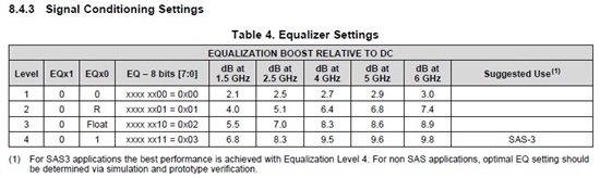

I have a 10GbE SFP+ active cable project
Seems like DS125BR111 and DS100BR111 is p2p ,I would like to design DS125BR111 in this project ,
Could I use DS125BR111 for 10GbE SFP+? Due to the SD_TH is not different with DS100BR111
