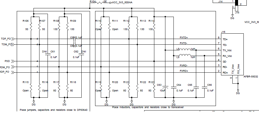

  • Dear Sir,
    I am also facing the issue of DP83640 not pinging in fiber mode.
    I am using AM3354 processor and interfacing DP83640 chip over RMII mode. DP83640 is prefectly pinging while it is used in COPPER mode.
    Hardware Strapping are as belows:
    For Copper mode, LED_ACT (Pin 26), LED_SPEED(Pin 27), LED_LINK(Pin 28) are individually pull up using 2.2K resistor and RX_ER(Pin 41) is also pull up using 2.2K resistor. IN copper mode, DP83640 is pinging properly and link is also detected in linux console.
    For Fiber mode, LED_ACT is pull up using 2.2k and RX_ER is Pull down using 2.2k while LED_SPEED and LED_LINK  pins are floating. We are using AFBR5803TZ fiber transceiver and SCto ST fiber multimode cable. But, we are not able to ping in fiber mode. Link is also not detected in linux console.
    Please find below schematic of fiber optic connector. Please suggest the solution.
  • Hi Ajay,
    LED_ACT and RX_ER strap configuration looks ok. Can you connect AN1 ( Pin 27 : LED_SPEED/FX_SD) to Signal Detect of the Fiber Transceiver.
    Also, do you have ability to read register of Phy thru MDIO access ?
    Geet
    Thanks for Reply.
    AN1 is already connected to PSD line Pin 4 of Fiber transceiver.
    Currently, i am not reading register of Phy as i thought i can manage fiber mode just by hardware strapping registers. Also, for copper i am managing the same way.
    Can you let me know what should be the electrical voltage levels over TX and RX lines of fiber transceiver? Is this can be issue. Registers values we used are as per schematic already attached in previous update. I have tried changing values of R117, R118, R121, R122 from 80 ohms to 82 ohms. But no improvement.
    One observation i found is as per below.
    If i keep my development board in Power ON condition and then just give power reboot to my 100baseFX to 100BaseTx media convertor, i can see below messages on kernel console of my board.
    Link is Up - 10/Half
    eth0: Link becomes ready
    But, still cannot ping while my converter shows FX 100Mbps led and FX link signal available.
    And, if i give power reboot to my board, above messages do not appear on console and shows link not ready.
    Ajay
  • Your earliest post mentioned that both Pin 27 and 28 are floating, hence the recommendation to connect 27 to Signal Detect of Optical transceiver.
    While Phy is configured in Fiber, we shall only see 100M as 10M is not supported. I would need to see Status register 1 and 10 to understand status of Phy in both scenarios: a) Link Partner power cycle, b) DP83640 power cycle.
    Geet
  • I am checking the RX signal on CRO after pinging my development board from my laptop. But, i am not seeing any data signal on CRO. My RX lines are at continous 2.2V but no data coming on RX pins of Fiber transcevier AFBR5803TZ connector, checking on CRO.
    Also, can you guide me how to check status register 1 and 10 in kernel. Do i need to read in dp83640 kernel device driver.
    Ajay
    These register provide information on the Link Status and Configuration of device. Refer to DS for details on these registers.
    http://www.ti.com/lit/ds/snosay8f/snosay8f.pdf
    THese have to be accessed thru MDIO/MDC interface. If your driver provide interface to read the registers, you can use this.
    Geet
