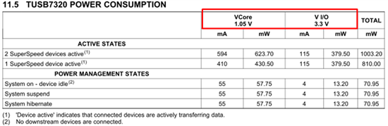

What is the current consumption for TUSB7320 "VDD3P3" pin ?
The device has three types of power pins which are VDD33, VDDA3P3 and VDD11. In the figure below, I believe "Vcore" stand for VDD11 pin and "V I/O" stand for VDD33 pin.
