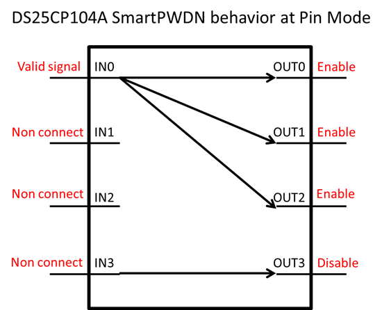

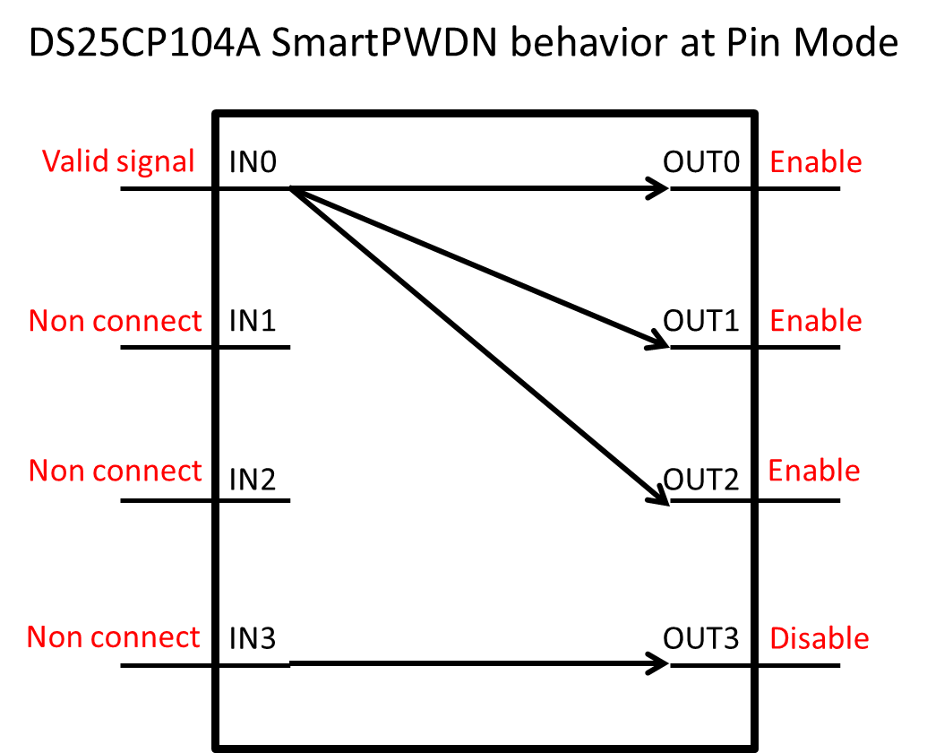

Our customer will use DS25CP104A as a 1:3 crosspoint switch. Customer requirement is to use in pin mode and output enable function for each output.
To configure output disable, I believe you could achieve by switching the output to the non connected input, if SmartPWDN function is enable at pin mode.

    [A1]: The SmartPWDN circuitry or functionality is only available in SMBus mode.  In pin configuration mode the PWDN pin will enable or disable all four device outputs together.

    [A2]: Smart PWDN disables an output driver when none of the four inputs are conigured to be connected to the output driver in question.  This is only available in SMBus mode.  Smart PWDN is used withthe SMBus Control Register at Address 0x03.  There is additional information in the "Register Descriptions" section fo the datasheet.

    [A3]:  In pin mode operation it is only possible to enable or disable the entire device at once using the PWDN# pin.  I would set the 4th output to connect just like the other 3 creating a 1:4 function.  Since the 4th output is not needed, just terminate it with 100 ohms at the output pins.

    Our customer's requirement is to enable/disable each channel independently with pin configuration. I think there is no device which could meet their requirement completely. I believe customer would need to use SMBus Mode to achieve this.
