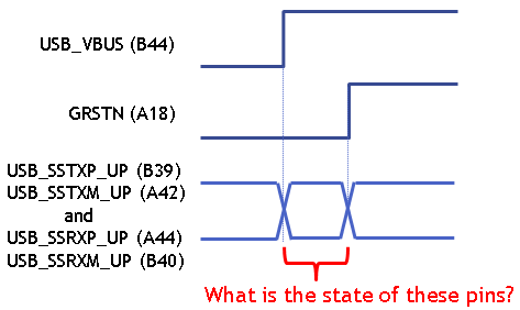

Hello Yaita-san,
Per USB spec this port shall be disabled at this point, however I am not sure about the actual implementation, let me ask my team to provide a precise feedback.
Diego.
Hello Yaita-san,
The SS upstream port is a differential port, which is disabled during reset operation, therefore the TX pair would be in an undetermined state, meanwhile the RX pair shall have its far end termination disabled (50 Ohms).
Diego.
Hello Yaita-san,
You are correct, the R_Term is the far end termination resistor I mentioned.
Diego.
