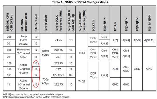

Hi Team,
My customer use the sensor, AR0388
Customer said AR0833 is an Aptina sensor that output is in 10bit per pixel.
Because we do not mention if Aptina 10bpp is supported or not.
Could you please help me to check SN65LVDS324 can support  AR0833 or not?
Thanks.
Prescott
    The LVDS324 only support the sensors described on the Datasheet.
    Nevertheless, I am forwarding your question to the device champion and he will contact you in case it could be supported.
  • Hello Prescott,
    Elias is right, indeed the SN65LVDS324 does not support the Aptina 10bpp mode. Furthermore please take into account that the SN65LVDS324 has the following jitter tolerance:
    Total Jitter (Tj): 190ps
    Random Jitter (Rj): 8ps
    Deterministic Jitter (Dj): 80ps
    (this values are not included on the datasheet yet, but we are working on include it).
    Diego.
