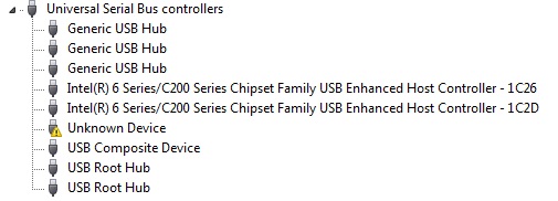

When we power up the board and connect the Upstream port to a Windows 7 laptop to troubleshoot the board, the laptop detects the USB hub as a Generic Hub and also Unknown device. See screenshot below.
For the three generic hubs listed, one of them is the TUSB2036. I know this because, I’ve checked the ID on device manager. The other two is the internal hubs on the laptop.
TI 2 port hub is shown in device manager as- Port 5, Hub 3 and the HW ID: USB\VID_0451&PID_2036&REV0101. The unknown device is shown as Port 1, Hub 5.

2. Why is there a Generic Hub and Unknown device showing at the same time in the device manager?
