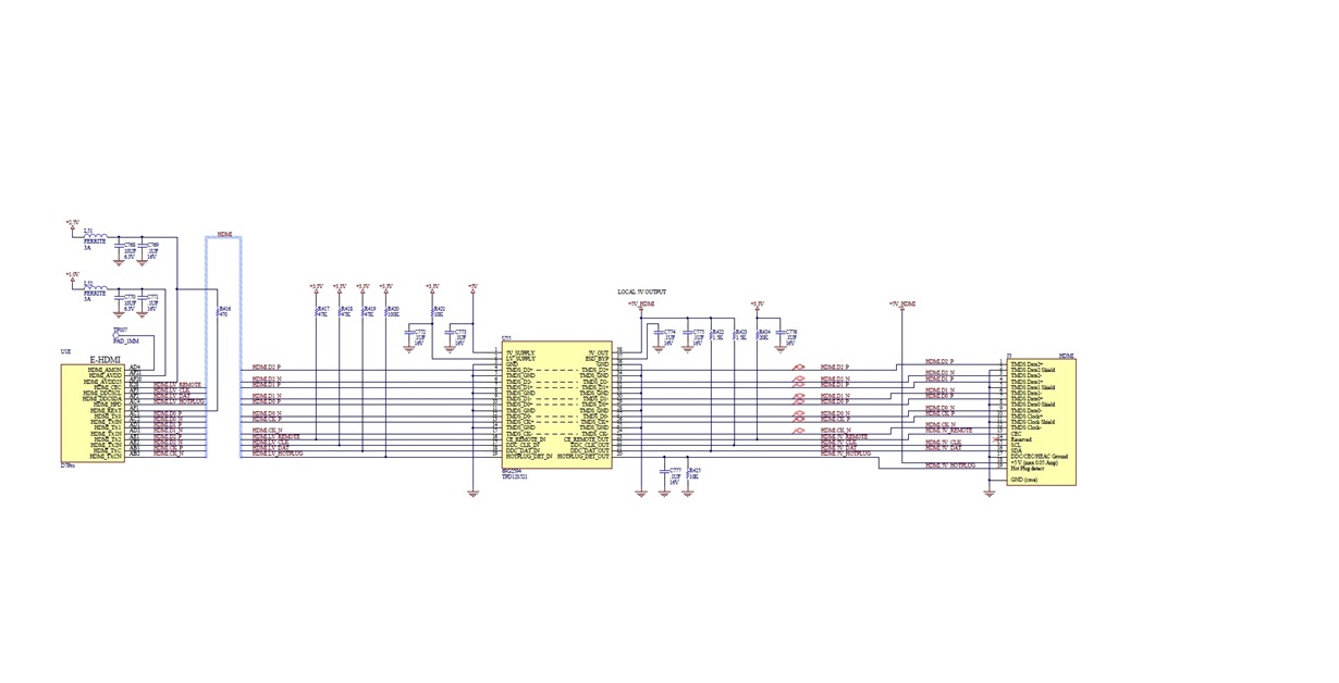

  • Guy how can i send you a schematic?

    To attach a file, select the use rich formatting link.
    I can do the same measurement early next week, but I believe that the RC constant is too small with the needed pull-up and bypass capacitor so that this test will not pass. One difference between our devices with built-in pull-ups and this scenario is that when the device with internal pull-ups is powered off, the pull-ups are switched out of the circuit as well. Therefore the bypass capacitance is switched out too.
  • Guy this is as good as I could figure out to post. It isnt very readable but on the right side is the HDMI output from the SOIC which in the center enters the TI device then on the very left hand side is our HDMI connector. It is pretty much a copy of the suggested ON Semi connections and TI connections but the differences are 5V connections on the TI datasheet are to the 5V input and the ON Semi are to pull up the resistors via 1.5k resistors to the 5V Out pin 38 of the device.
  • Guy so I think we will have to spin boards and put diodes in series with the CLK, DAT, and CEC lines to fix this issue. But maybe for future products we should consider a newer device do you feel the TPD12S016PWREVM would be the device to use or is there a better substitued to use going forward?

    I agree that it will take diodes to hide the capacitance on that rail. TPD12S016 will definitely solve this issue, even with bypass capacitance on the pull-up rail. The reason this is a solution is due to the fact that with no power to the system, the pull-ups are switched out of the circuit.
