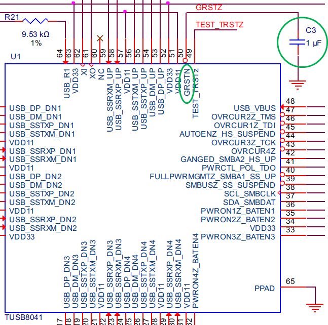

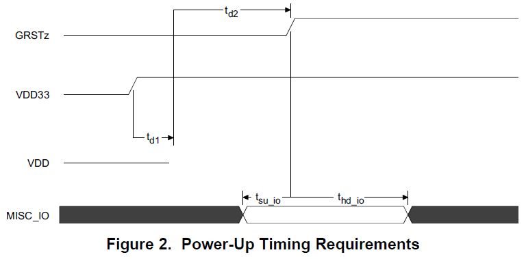

I understand that there is the sequence requirement between GRSTz and VDD/VDD33 as stated in Figure 2 of datasheet. But the EVM has only decoupling 1uF capacitor on GRSTz. Does it means that we do not need to control GRSTz pin at power up to make delay following this sequence requirement?

  • The TUSB8041 has an internal pullup on GRSTz. For most applications, the passive reset circuit created by the external cap and internal pullup provides an adequate reset pulse on GRSTz. We ask that customers verify this in their design, since they may need to vary the value of the external capacitor. Also, if a customer system ramps 3.3V before 1.1V, an active reset may be required because the internal pullup on GRSTz is connected to the 3.3V rail.
  • Hi JMMN,
    Regarding power up sequence, can we ramps 1.1V before 3.3V? Is there any timing requirement between 1.1V and 3.3V at ramps 1.1V first if it can be accept?
    Sonoki
    It is OK to ramp VDD11 before VDD33, in this case you will have to use the external capacitor connected on GRSTz in order to meet the power-up timing described in datasheet.
