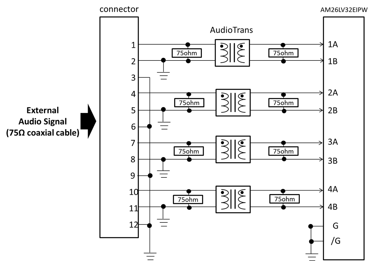

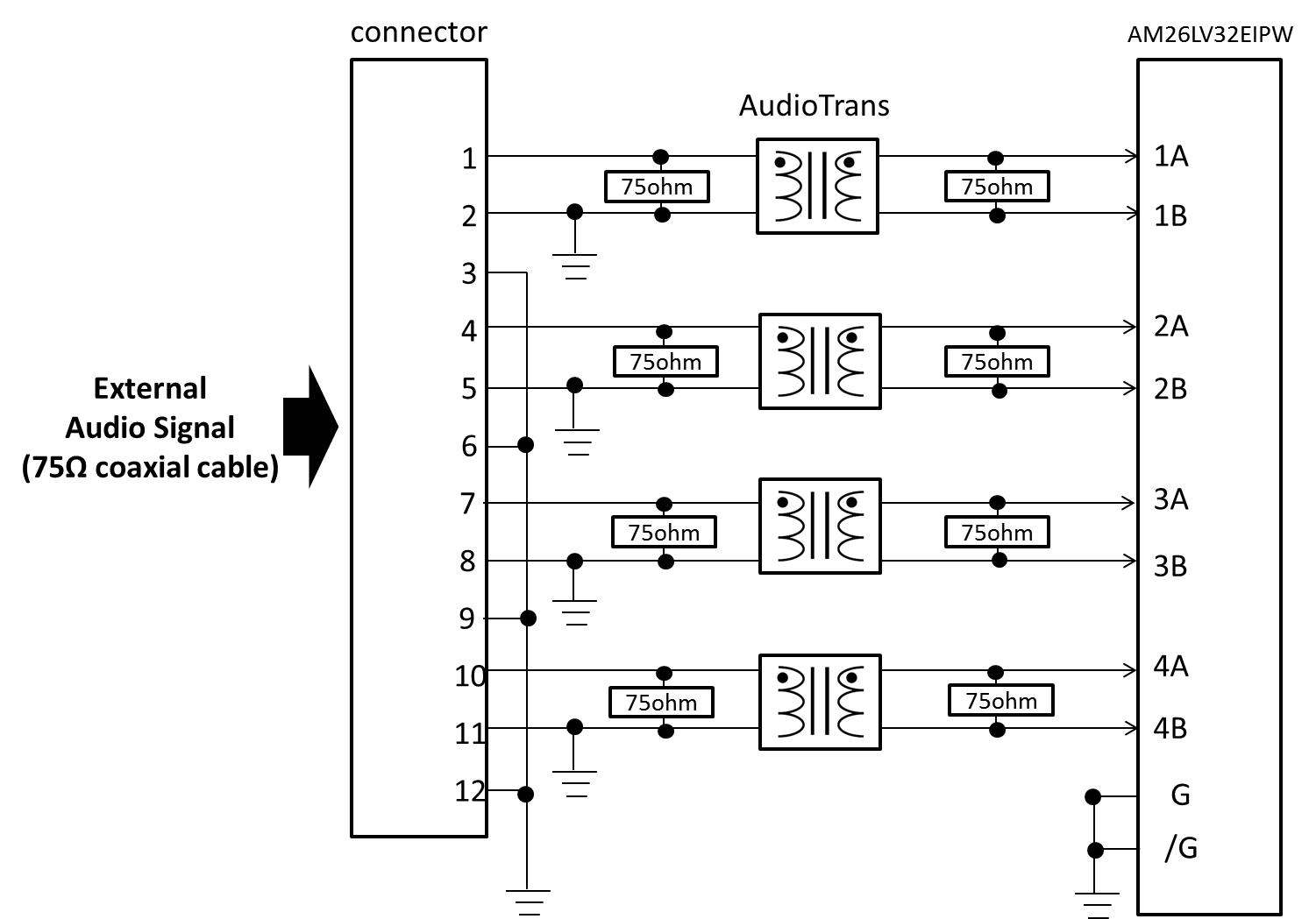

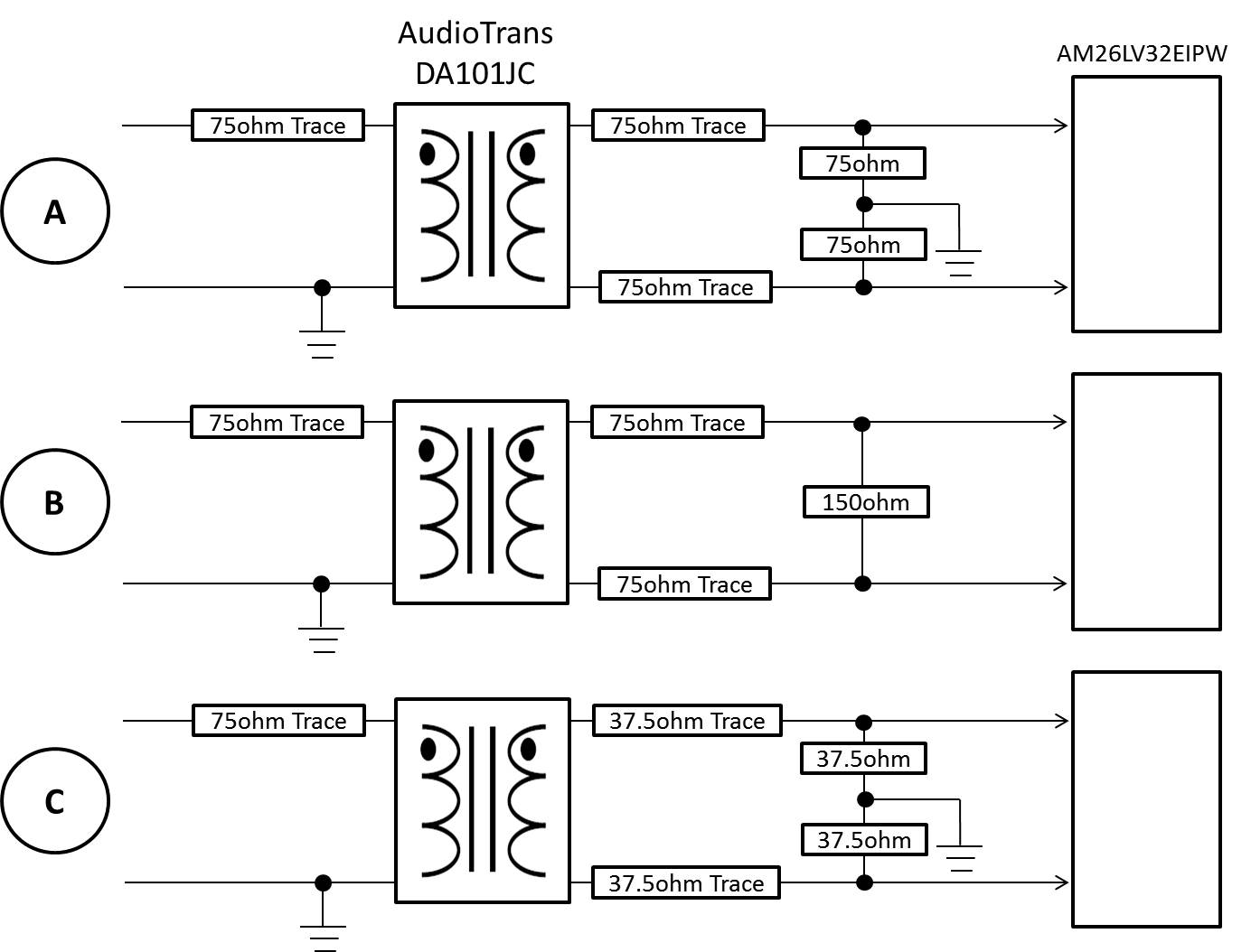

Hello Team,
I'd like to ask you about AM26LV32E.
Is there any problem with the belowing figure?
My custermor want to know the proper rating of termination registor.

Hello Ron,
Thank you for your reply.
>Do you have correct data stream (no DC)?
I'll confirm data stream.
>I would like to see the 75 ohm resistors replaced with two 37.5 ohm resistors and the center tap grounded. Gives a input common mode of zero instead of floating.
>The 75 ohm resistors on the transformer primary should not be needed. Because the secondary resistors are reflected through the transformer (assuming the transformer works well at the input frequencies).

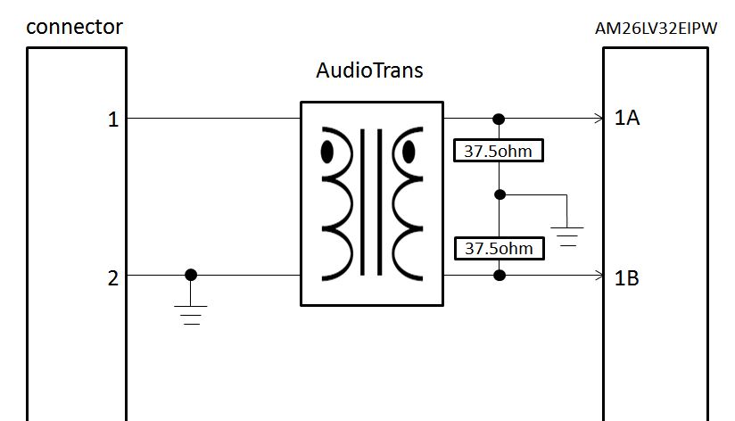

I understood it as the following constructure but is it correct?
Also could you tell me the reason why is replacement resistor rating 37.5 ohm?
The transformers just for single ended to differential.
Could you tell me how to hot-swap countermesure because my customer would like to know it?

Hello Ron,
Thank you very much for your reply.
I understood it.
Also I get the following information for data streem.
Input Audio Signal Standard:AES 3id
data rate:7.68Mbps
amplitude:1.0 V ± 0.2V.
DCoffset:0.0 V ± 50mV.
Please let me reconfirm this to make sure.

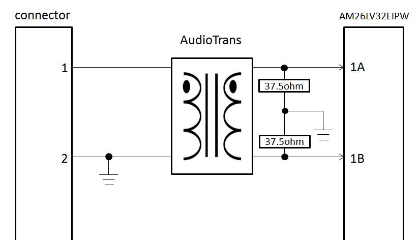

Is the proper constructure not "A", "B" but "C"?
Also can the transformer protect the following ESD level?
contact discharge:8kV(IEC61000-4-2 Level 4)
air discharge:8kV(IEC61000-4-2 Level 3)
secondary discharge:12kV
MO medium charge:10kV

Hello Ron,
Thank you very much for your support.
>The transformer is for audio signals; what is your data bit rate?
data rate:7.68Mbps
Could you tell me the reason why is “C” best? Because I thought “A” is better before.

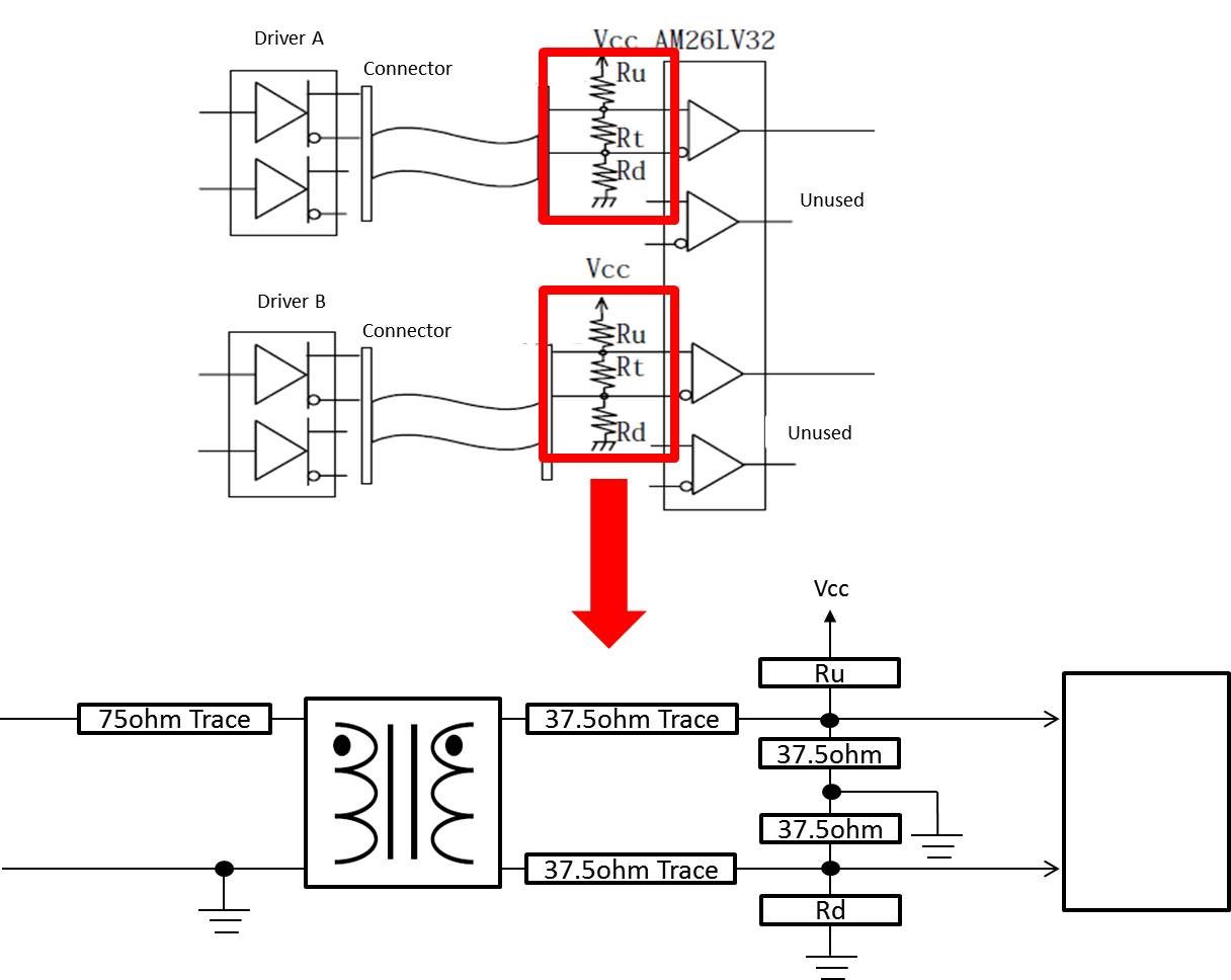

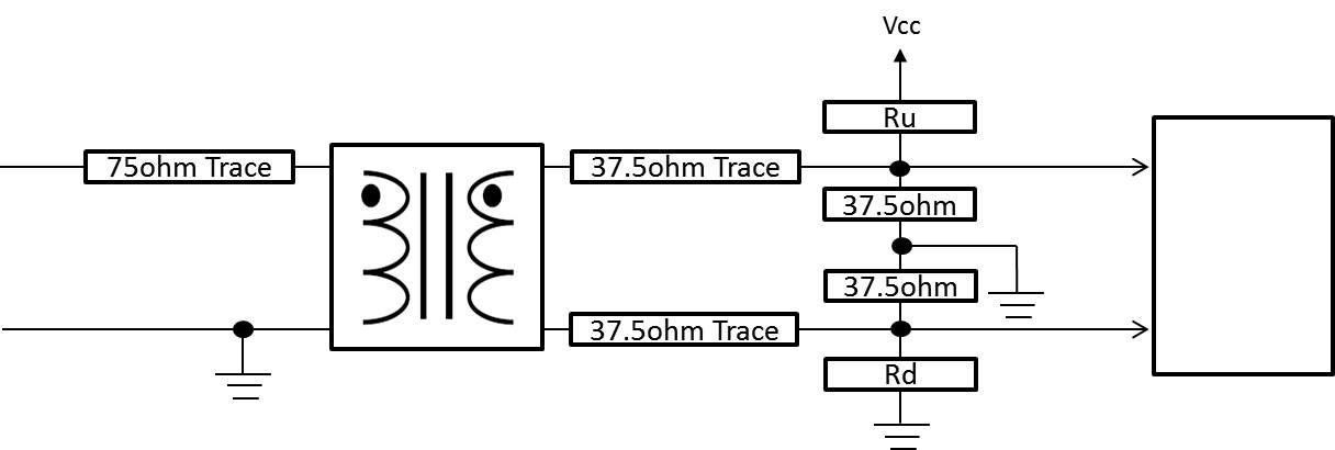

Also according to Japanese application note, there is the recommended circuit if several drivers connect to respective cable.
Could you tell me the rating of pull-up(RU)/down(RD) resistor in the following figure?
Hidetoshi Matsunami
Hidetoshi-san,
Think about secondary being a center tap transformer. Each side of the tap has 1/2 of the voltage and same current as the primary (75 ohms). So impedance is half. Both halves add back to 75 ohm, just like 37.5 ohm terminations.
For RU and RD see RS-485 Design Guide http://e2e.ti.com/support/interface/industrial_interface/m/videos__files/264978/download
