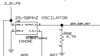

I am using TLK110 in RMII mode. I had a problem with the clock wave form input to PHY TLK110
According this post, the clock connection between TLK110 and CPU (i.MX6) is as below in my design. External oscillator has total load capacitance up to 15pF, branch to PHY and CPU. External oscillator is placed near PHY side

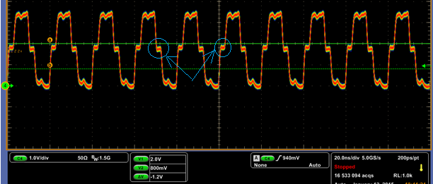

The clock wave form input to PHY is below.
It has a stop on both raising and falling edge, due to the clock signal reflection from CPU, I think.
Is there any restriction of the raising and falling edge clock on TLK110 ?
Do you have any recommend how to branch the clock signal?
Is this wave form good or not?
