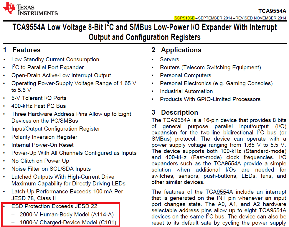

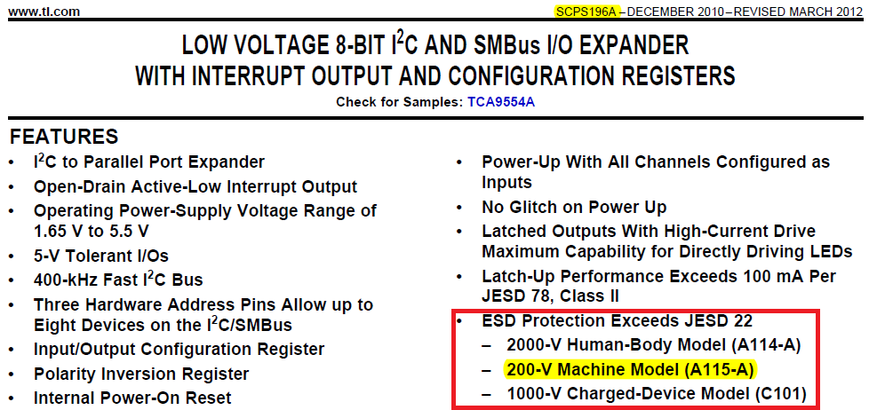

Hi Team,
We found difference between “Old datasheet (SCPS196A)” and “New datasheet (SCPS196B)”.
So, we would like to know the reason why " 200-V Machine Model (A115-A)" is not listed in the New datasheet (SCPS196B).
Could you please let us know it if you have any information?
