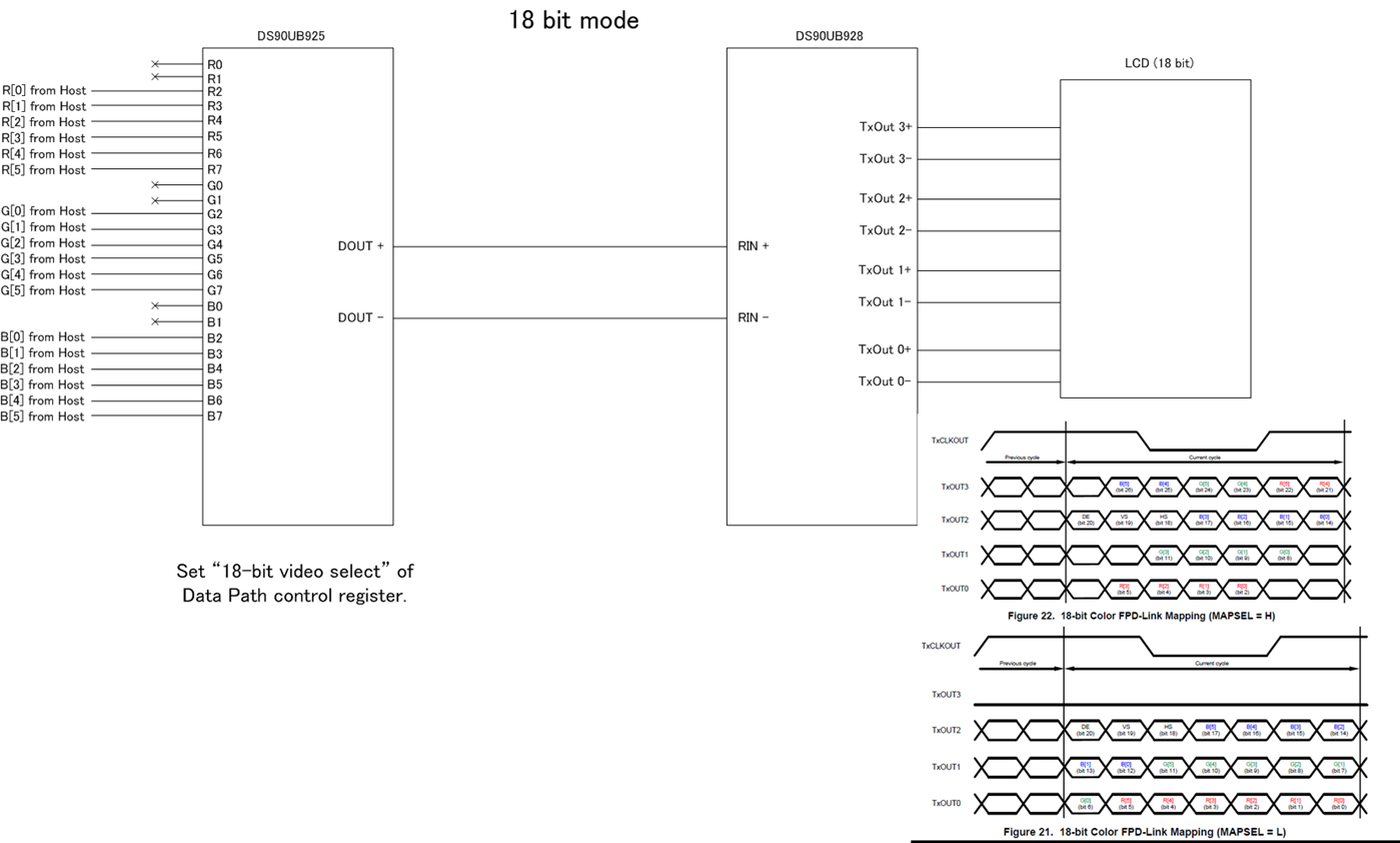

Hi expert,
My customer asked us how to connect b/w DS90UB925 and Host when 18 bit(RGB666) will be used.
Here is my understanding about case of  "18-bit video select" of DS90UB925 is enabled.
Could you confirm whether connection b/w Host and DS90UB925 is correct or not when "18 bit video select" is enabled ?
