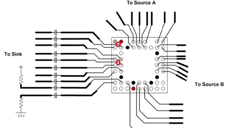

I refer to HD3SS213's datasheet ,The layout minimum pad recommend 0.25mm
But our layout team told us ,if the pad need this minimum size ,the layout trace width will be 2mil through between pad and pad (please refer to below red mark)
Our PCB maker can't build 2mil of trace width ,the limit is 4mil of trace width
I would like to know HD3SS213 or HD3SS215's EVM layout trace width on this area ,is it the same of 2mil??? (May I have a figure to show the trace width by Allegro?)
