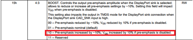

Could you please let me know who take care SN75DP130 issue?
My customer, did the DP testing and got the fail result.
HD263&XTC3-4C2U1F1A Lane0&1_20141120_184819 is shown the testing result under default setting. (Pre-Emphasis Level Verification Testing Fail)
So I recommend customer to set the DP130 local register 15’h = 0x10’h. to increase pre-emphasis.
Then run the testing again.
TekExpress Display Port report_ DUT001 is shown the testing result after set the DP130 local register 15’h = 0x10’h. (Pre-Emphasis Level Verification Testing Fail Again)
Please give some feedback on this issue.
