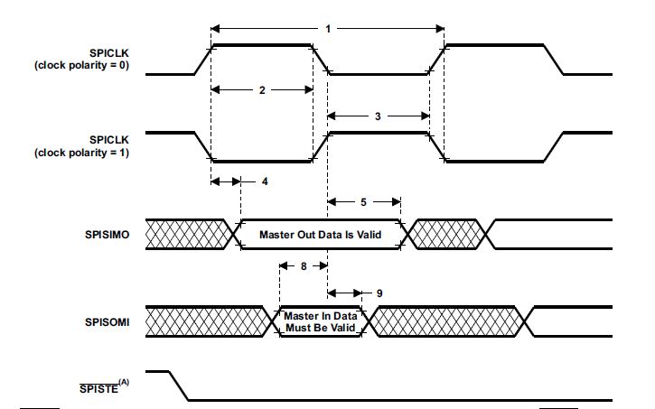

I am using an ISO7241CDW to isolate an SPI bus. I have two DSPs in the setup, one works as master, the other works as slave. They talk to each other via SPI bus. My problem is that it seems D channel doesn't support the SPI speed higher than 4Mbps, but in the datasheet, it says 25Mbps. When I set the SPI speed higher than 4 Mbps, channel A,B,C are ok, slave DSP can receive correct data, but the master DSP received messy data, lost many bits. When I set the SPI speed lower than 4 Mbps, all the channels work fine.

SOMI --- PIN 6 (OUTD) PIN 11 (IND) --- ISO_SOMI
I connected 0.1uF capacitors in both side as suggested in the datasheet.
Did I understand something wrong of the isolator?
