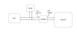

In one of our design we have used TCA9406 as a level-translator for MDIO/MDC signal. Please find the below system description. We have the following observations:
1. When 3.3V source2 is turned off, the MAC to TLK105 interface is working properly. But with both 3.3V sources that interface is not coming up.
2. When both the power supplies are ON and when we probe the MDC signal at the input of TCA9406(signal going to TLK105 PHY) the interface is working properly.
3.When the SCL2 and SDA2 pins on the 3.3V source2 is lifted, the MAC to the TLK105 interface works fine.
I would like to know how the interface works properly on probing.(mere touching of the trace with the probe irrespective of whether the probe-ground is connected or not)
We have 2.21k pull-ups on both signals (3.3V source1) and 4.99K pull-ups on both signals(3.3V source2). We have used 200K to connect the OE pin to the 3.3 source1.
The frequency of SCL is 200KHz.
We are not using TCA9406 for any voltage translation. We have used TCA9406 as the MAC and 10G PHYs are in different power supplies.(same voltage different current)
