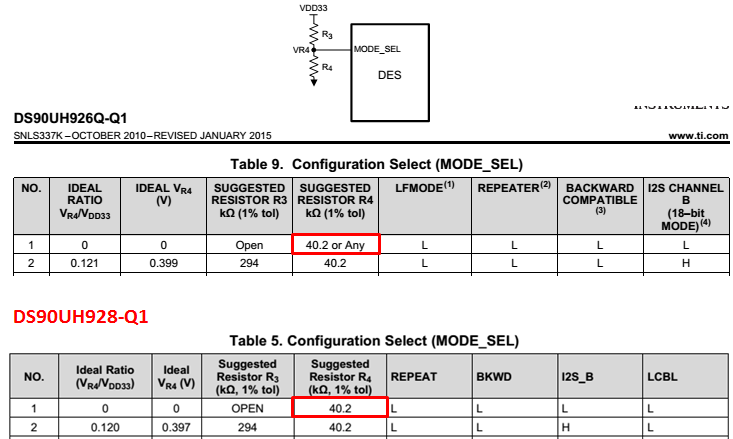

As for a resistor for MODE_SEL pin of DS90UH928-Q1, can I consider to be same as DS90UH926-Q1? See drawing below.

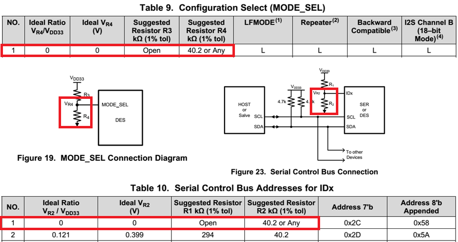

Yes. For the first level (target voltage = 0V) the resistor value is not as critical as the other levels.

Hi Ken,
Yes, 0 Ohm is fine in this case. I would still recommend putting the pads for pull-up so that you could use a different mode later on if needed.
