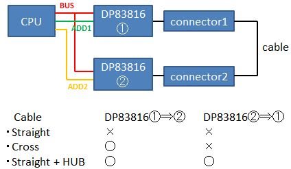

Customer has loop back test error for DP83816. their system couldn't communicate normally.
The results differ from cable categories as follows. (○→OK, ×→NG: time out)
Is there something that is considered to be the cause of that?
